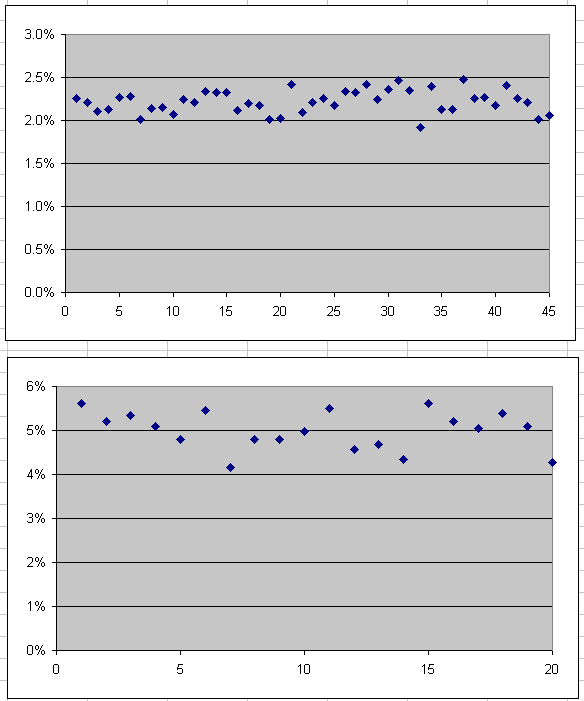

Oopsa. Looks like this lottery is not as was thought. You play 5 numbers from 1 to 45 and 1 number from 1 to 20. Chances of a ticket winning are then 1 / (45 choose 5) * 1 / 20 = 1 / 24,435,180.
  • #56
And here are the histograms of winning frequencies for the first 5 numbers and for the 6th number:
Not quite as sloped as expected!

That's exactly what those histograms disprove, whatever effect there is it is very weak. Could give it a value if you want to, the sum of frequencies for numbers 1 to 30 is 66.48% while it should be 30 / 45 = 66.66%. They are a tiny bit LESS popular than higher numbers!

The histograms show no preference for specific numbers but they don’t show preferences for specific combinations.
