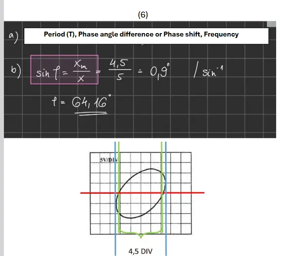

6) The following waveform was observed on the oscilloscope screen:
a) What quantities can be measured based on the displayed waveform?
b) What is the phase difference between the two compared sinusoidal voltages?
The problem statement doesn't seem to say that the amplitudes of the two sinusoids are the same. What effect would different amplitudes have on the displayed figure?
