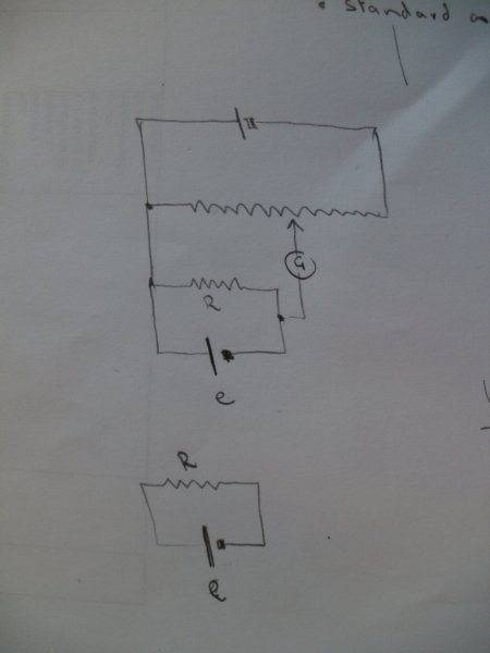

For R, current I=E/R and for X, I=E/X... both are separate cases.
[/B]
Why does the balancing change?
The potential difference across each resistor is E Itself right?
I tried by assuming an arbitary internal resistance r.
but in the book, it given as:
E2/E1 = iX/iR
but how is I same in this case when resistance is varied? They have given that I is the current in potentiometer wire... but how does the that current cause potential difference across R? It should the current E/R or E/X that passes through R and X.

Potential difference across balancing lengthfor case R Is ##V_1=\frac{V_0l_1}{L}##
And for X ##V_2=\frac{V_0l_2}{L}## where l1 and l2 are balancing lengths and V0 is the potential difference across entire length.
in the lower circuit, for R, ##i_1=E/R## and for X ##i_2=E/X## where E is the lower cell. So ##\frac{I_1}{I_2}=X/R##
V1/V2 = l1/l2
But ##\frac{V_1}{V_2}=\frac{I_1R}{I_2X}## if you substitute value of ratio of the currents which is equal to X/R, you get V1=V2.
The cell establishes a current through R (or X) irrespective if the balance point
have been found or not. All that the potentiometer does is it measures the potential
drop over the cell in this state, which is not e when it is balanced since the resistor
(R or X) is drawing current from it.

At balance point, the the current from upper cell will not pass through the lower cell because the potential difference across that part of wire Is same as that across the resistor.
also, since internal resistance is zero, V=iR=E from kirchhoff rule in lower loop.
