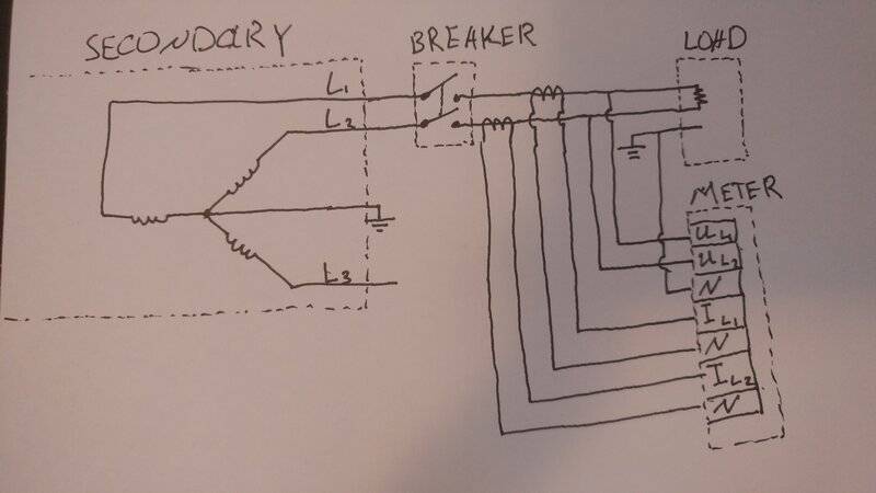

  • #38
aemla said:
I believe below is what you are describing.
Yes, precisely that.
Cheers,
Tom
  • #39
Cheers,
Tom

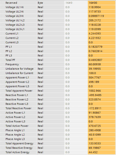

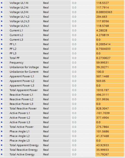

This is how the wiring has been since day one. The results shared earlier are based on this wiring
  • #40
This is nuts...
Likes russ_watters, aemla and berkeman

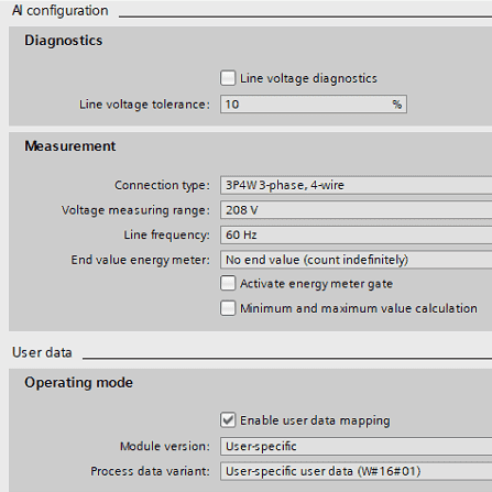

Would you happen to know which one? There are only couple pages of wiring diagrams to look at.
Yeah I agree, that top diagram makes more sense for the wiring of the actual load, however, the previous meter does not have such configuration.
I did try 3 phase 4 wire (as shown below) configuration, results were the same as shown in the previous screenshot.

The pic in post #44 should do it. I assume there are configuration setting you need to set to match the connections.
  • #46
I did try that, results were the same.

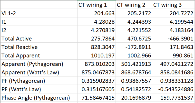

I am quite certain you have a CT polarity wrong, the only way to get a -105 phase angle.

At this point I need to know more about the setup. To get any more help here you are likely going to have to get some known resistive loads and try various things.
  • #49
Okay thank you, I'll check the setup in more detail when I can. What about a hypothetical situation? When I have readings with respect to N (L1-N voltage, L1 phase angle, L1 current AND L2-N voltage, L2 phase angle, L2 current), is it possible to calculate active power between L1 and L2?

This is what the internal wiring of the meter suggests. There are no sensing elements between phases, all of that is calculated. Unfortunately, I'm unable to test with various loads, just have the one 208VAC load.
Sure, I understand that. In a three phase system using a three wattmeter method, you can simply add all powers together to get the total power. This is what the meter is doing. This can also be considered as 3 single phase loads (L-N loads).
If you actually have single phase L-L but configure the meter for three phase system with a three wattmeter method then you won't get correct results. I've previously showed the power calculation example.
  • #60

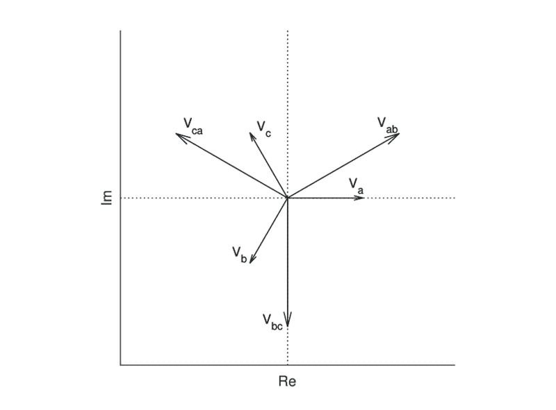

You do not need to sense L-L, this is where the vector diagram and understanding it is so important. The sensing elements are looking at the waveform, not just a V measurement like a DMM.
if you draw the 2 L-N vectors, the L-L voltage is fully defined, it is the vector sum.
If you measure the three L-N voltages, you can define the entire 3 Phase situation.

Concerning 120/208 Wye, voltages all referenced to neutral:
You want to take the cosine of 30° and multiply it by the line voltage of L1 then multiply by the current. That is the true power that L1 winding is sourcing. Do the same with L2. Do you understand why 30°?

Per my understanding and looking at the phasor diagrams, 30 degree shift is between V(L1-L2) vs V(L1-N). Is this statement not correct?
  • #67
The reason I used 30° is because there is a phase shift of 30 between line to neutral and line to line voltage. The current will align with the line to line voltage phasor in a resistive load. So you have multiply the current by a voltage phasor that is parallel to the current phasor in order to come up with true power. Make sense?

  • #69
When we say current will align - correct this is not considering the reactive elements, but referencing the relationship of the SENSING/Measurement. So yes - think in terms of resistive loads.
For ADC systems you are sampling ( digitizing) the waveform - and this has a sampling rate that should be many times higher than the fundamental. But this is not as high as typical audio sampling - so really not too high in frequency overall and not a significant cost adder. One thing that is needed is the V and I need to all be sampled at the same time - but still Digital metering overall costs much less than other methods today.
It seems you are beginning to see the light.
SO - if you ONLY had a single L-N system. V1-N and I1 - are measured and accounted for with no phase shift. ( Phasor diagram - the V and I phasors are aligned)
If now it is a three phase system - but there is ONLY one load connected L-N the power is the same - correct? ( the other Phase-Neutral voltages are present but have no impact in the POWER - so whether they are there or not is irrelevant to POWER)
Next - you have 2 separate loads connected L1-N and L2-N -- each phase phase has power - and the power of the system is just the SUM. ( power is a scalar).
Now - connect a load from L1 to L2 ( not to the neutral) -
The real current is V L-L ( vector) / Load.
each phase CT "sees" the same current, but it is "in" one CT and "out" the other. The meter evaluates each, so in one case the real current is shifted 30 Deg Leading (ahead) of the phase voltage and in the other it is shifted 30 deg Lagging(behind) the phase voltage- each is phase shifted from the Phase-Neutral voltage that it is measuring
This is becasue becasue the voltage applied to the LOAD is VL-L (vector) = VL1-N(Vector) + VL2-N(Vector) -- this is where the 30% comes in.
So again - this can be a single phase L-L load and a 3 phase meter will still read the POWER correctly. The presence of the third leg voltage is irrelevant to the power measurement.
