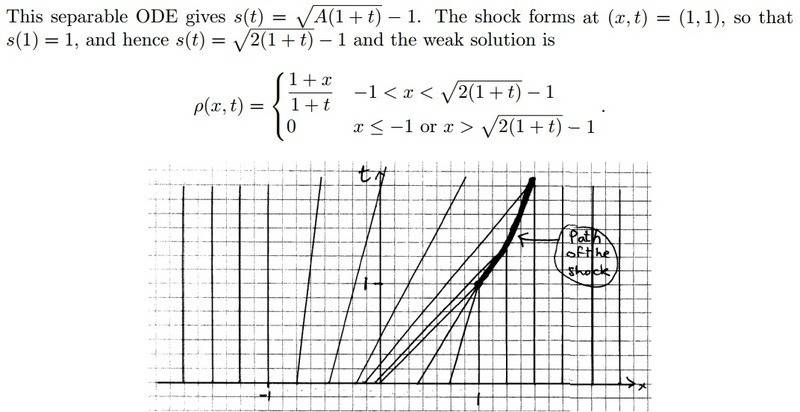

A very simple problem that is probably the key problem for me is the fact that x and t are easily compared and interchanged. I do not understand how one can compare time and distance. For example saying u = 1 for x<-t. Should I somehow think in 3D ?
This is a very simple problem with the t and x comparison.
http://s12.postimg.org/xv0wzdcn1/Chars.jpg

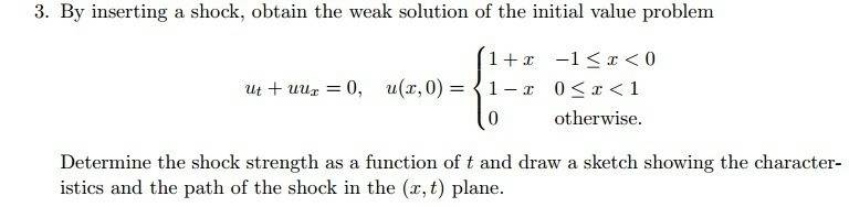

We need the actual equation to be able to give you some advice.
Sorry, I have not realized that did not fit.
It's [itex]u_{t}+uu_{x}=0[/itex] and u(x,0) = -1 for x<0 and u(x,0) = 1

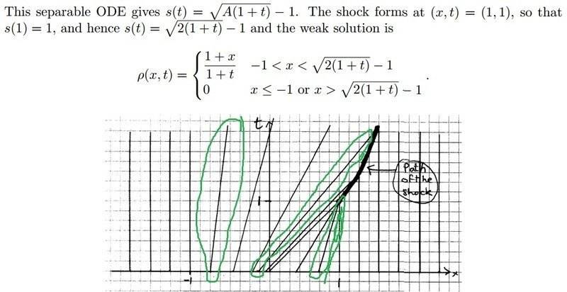

This states that u is constant on the characteristics.
I think I get that (and I thought that was the whole point of characteristics, that u is the same on a characteristic). What I do not get is how we compare time t and space x...
You have to compute the characteristics, write dt/ds=1, dx/ds=u. with t(0)=r and x(0)=0.
Yes, I know how to algebraically get the expressions in the picture of the solutions I have attached. What I do not understand is why are we allowed to compare x and t ?
You're mapping the characteristics.

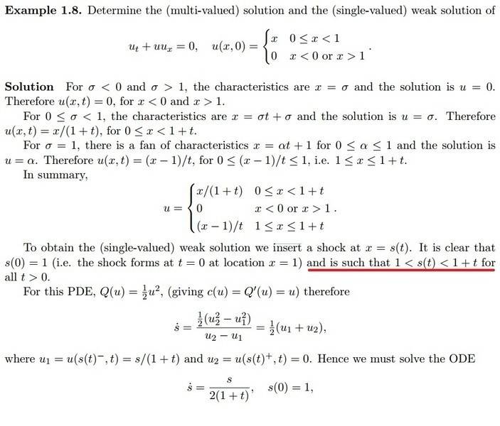

I'm having trouble with this question:
The "shock location is obvious" for me it is only obvious if I draw the picture, maybe I should look at the limits ?
But the real problem to me is understanding how were the limits for s(t) (underlined red) established ?
Do you know how to compute characteristics? If I have a hyperbolic PDE, I can write down the characteristics as
[tex]\frac{dt}{ds}=1\quad\frac{dx}{dt}=u,\quad\frac{du}{ds}=0[/tex]
Then consider what [itex]u[/itex] is in those separate regions.

To see which variable has the zero initial condition, look at the initial condition for the PDE u(0,x). The characteristics should come from that initial curve, so t=0 when s=0, because s=0 is when you are at the initial condition. However x is not-zero there so set it to some (as yet) unknown value (the solution calls it [itex]\sigma[/itex]), so you have to solve the equations:
[tex]\frac{dt}{ds}=1\quad t(0)=0,\quad\frac{dx}{ds}=u\quad x(0)=\sigma ,\quad\frac{du}{dx}=0,\quad u(0,\sigma )=...[/tex]
Where ... are the two cases mentioned in the problem. Let's examine the case for ...=0, what does this make the equation solution?
I assume you are talking about the most recent problem, so
[itex]u(0,\sigma) = \sigma[/itex] and that will let us solve for x i.e. [itex]x = \sigma t + \sigma [/itex] for the given limits (with now [itex] 0 \leq \sigma < 1[/itex] ). I then rearrange for [itex] \sigma = x / 1+t [/itex] now look at limits [itex]0 \leq x/1+t < 1[/itex] and then consider the two cases when t > -1 and t < -1 (the latter just inverts the order of inequalities) (But I think we assume t > 0, because in the solution it does not consider this case). Then, since [itex]\sigma = 1 [/itex] is not included in the limits, there has to be a fan of chars. The form of u will be [itex] u = \alpha [/itex]. Hence the "fan" will be [itex]x = \alpha t + 1 (\text{here 1 is the sigma which was not included in the limits})[/itex]. Now the way I think one should get alpha (apart from drawing and looking for the jump) is to look at the case when t = 0 (not sure if this is general, but the discont. in this case occurs at t = 0 ). In this case alpha ranges from 0 (since that's the u which is after sigma > 1 ) to 1 (since at t=0 we have u=1 for the top expression of u). So we get the expression for u of the fan of chars. Now it also makes sense, why the shock location is at 1.
I now think that the reason for the limits on s(t) i.e. [itex]1<s(t)<1+t[/itex] is because we will always insert the shock, where the fan is (but not on the end points, because I think that has something to do with mass conservation (i.e. equal areas rule?))?
Does that sound OK ?P.S.

The function [itex]u_{0}(0,x)[/itex] isn't actually defined for x=1 oddly enough and I would expect it to be. The solution seems to indicate that it's 0, so let's go with that. the equations are then:
[tex]\frac{dt}{ds}=1\quad t(0)=0,\quad\frac{dx}{ds}=u\quad x(0)=1,\quad\frac{du}{ds}=0\quad u(0)=\alpha[/tex], these equations can be solved to yield the equation you said, the equation for x will give you the ranges for the validity of your solution.
