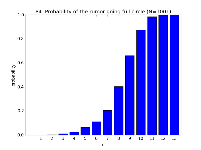

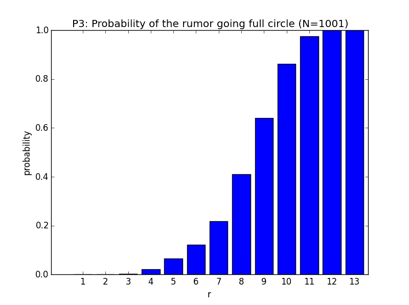

Challenge 3 and 4:

For N=1001, and r=5
Problem 3: 0.0564
Problem 4: 0.0571
So, there appears to be a slight increase in the probability.

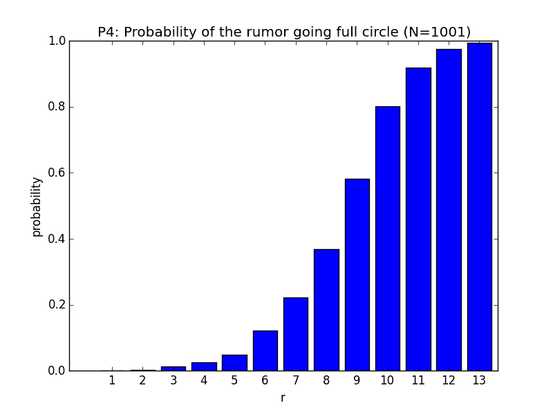

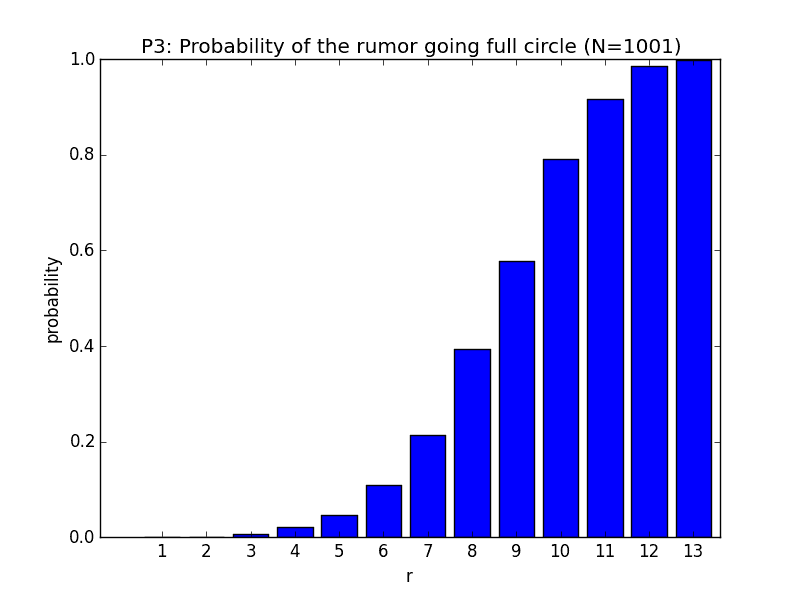

Can you perhaps provide some kind of histogram for different numbers of ##r## for both questions?

Yes, the python random.sample library generates random samples without replacement (i.e. unique samples)
I have included the histogram as requested for problem 3 and problem 4. They look quite the same.
Likes micromass
I realized I have a bug in my previous submission. When rumor is spread to next generation, there is a chance (which grows higher as generation increases) that the same person will be counted multiple times as a next gen candidate to spread rumor (because he was randomly selected by multiple parents). I have fixed this bug by using a set (no repetition) to store candidates for next generation. Below is the updated code (including plotting part), and new histograms.This change limits the growth of rumor compared to previous buggy version.

The graph I generate for #3 is quite different from the one above. For example, P(r) never reaches 1. Here's my semi-analytic, semi-numeric solution made while thinking of the answer to the probability challenge:

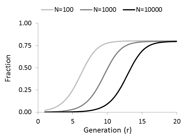

Building off of an approach similar to @mfb in post #91:
Let N(r) be the number of inhabitants in generation r. There are N(r) inhabitants who know the rumor and cannot pass it on to themselves, and n + 1 - N(r) inhabitants who do not currently know the rumor (let's call these inhabitants naive).
For case 2 (naive inhabitants), they have N(r) opportunities to hear the rumor in the next round. The probability that one rumor spreader passes the rumor to one particular individual is 2/n. Therefore, the probability that a naive individual does not hear the rumor is ##(1-2/n)^N##. The expected number of naive individuals to hear the rumor in the next generation is ##(n+1-N) (1 - p^N)##, where p = 1-2/n
For case 1 (rumor spreaders), they have N - 1 opportunities to hear the rumor as they cannot spread the rumor to themselves. Therefore, the probability that they hear the rumor during the next round is ##1 - p^{N-1}##, and the expected number of rumor spreaders who become part of generation r+1 is ##N(1-p^{N-1})##.
In total ##N(r+1) = (n+1-N) (1-p^N)+N (1-p^{N-1})## which simplifies to ##N(r+1) = (n+1) - (n+1 + \frac{2N}{n-2})p^N##
We can express, the fraction of inhabitants part of generation r, F(r), through the following recurrence relation: $$F(r+1) = 1-\left(1+\frac{2F(r)}{n-2}\right)\left(\frac{n-2}{n}\right)^{(n+1)F(r)}$$
Using the recurrence relation and F(1) = 2, I can plot F(r) for various values of n:
Solving the recurrence relation analytically would give a solution to the probability challenge, but I'm not sure how to do that.

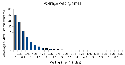

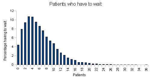

So I had a crack at #1, the doctors' office. Here's the code:
Python:
from __future__ import division
import math,random
# Constants
MEANTIME=10  # Mean time between arrivals
CLOSINGTIME=60*7  # Number of minutes surgery is open in a day
MINCONSULT=5  # Minimum consultation time
CONSULTRANGE=15  # Range of consultation times (=max time-MINCONSULT)
ITERATIONS=10000  # Number of loops round the simulation
DISPLAYSTEP=50  # Number of loops between printed iteration numbers
OUTFILE="C:\\Projects\\Physics\\Micromass simulation 1\\histos.dat"
# Empty arrays to hold results from each run of the sims
patientCount=[]  # the amount of patients coming to the office
waitCount=[]  # the amount of patients having to wait
averageWait=[]  # the average wait
closingTime=[]  # the closing time of the office.
# Simulation!
for i in xrange(ITERATIONS):
   if (i+1)//DISPLAYSTEP*DISPLAYSTEP==i+1: print "Iteration: "+str(i+1)
   # Initialise the first time the docs are free to zero minutes past 9am,
   # the latest arrival to zero minutes past 9am, and the number of patients

Basically it keeps track of the last arrival, each time adding ##-10\ln r## minutes, where ##r\sim U(0,1)##. It also keeps track of when the three doctors are finished with their current patient queue, and adds this patient on to the end of the first to become free, with a consultation time of c, ##c\sim U(5,20)##. I've taken "50% interval" to mean the range from the 25th to 75th percentile. The results I got are:
Amount of patients coming to the office (10000 iterations)
Median: 42.0
50% interval: 37.0 -- 46.0
Amount of patients having to wait (10000 iterations)
Median: 5.0
50% interval: 3.0 -- 9.0
Average wait (minutes - 10000 iterations)
Median: 0.46
50% interval: 0.21 -- 0.86
Closing time of the office (minutes after 4pm - 10000 iterations)
Median: 5.96
50% interval: 0.0 -- 11.2
Histograms:
