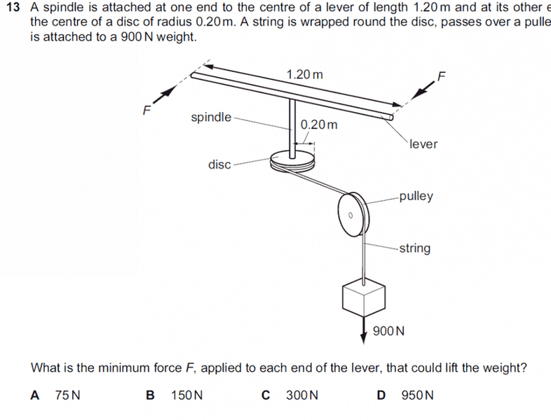

First, I calculated the couple about disc, though I'm not sure if I can use this approach. Since 900 N is pulling the string of pulley downwards, I take the couple about disc as 900 x 0.4, which gives me 360 Nm. To balance this couple, the couple by F must be equal to 360. So 1.2 x F = 360 which gives me 300 N as the answer. But I'm wrong, since the answer is B. Where did I go wrong?

900 x 0.4,
Any particular reason for using diameter?
I thought the 900 N exerts a couple on the disc, though I'm not sure. I'm just guessing.
What are/would be the two elements of the couple?
Two forces acting in opposite directions separated by a perpendicular distance.
What specific forces? And what distance?
In this case there's only one force which is 900 N rotating the disc in anticlockwise direction.
What's holding the disc?
The lever turning in opposite direction?
What's the "spindle" doing?
Bystander said:
What's the "spindle" doing?[/
Transferring the energy?
No sideways forces on it?
I totally don't know. From the picture, as the spindle rotates, it turns discs in opposite direction to the wight of 900 N on disc.
What happens when you pull the starter rope on a lawnmower without putting your foot on the mower to hold it in place?
The lawnmower will jump?
toforfiltum said:
jump?
Any particular direction?
I've never used a lawnmower before:-p so I'm not too sure.It will jump away from the person pulling it?
