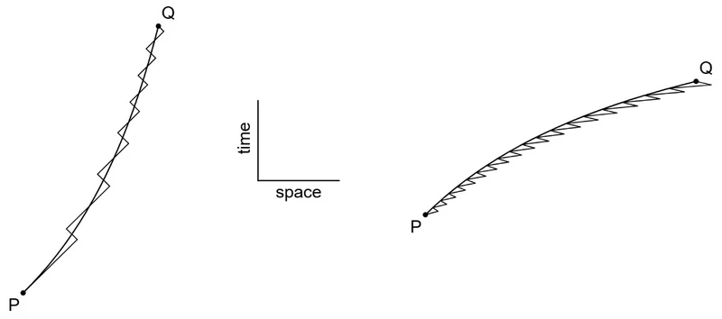

For a spacelike geodesic, it is easy to see that ##\int \sqrt{-ds^2}## is a minimum by considering nearby paths that make the integral arbitrarily large in special relativity. It is not so obvious how to extend this argument to curved spacetime.
Notation: The flat spacetime metric ##\eta_\mu\nu = \text{diag}(1,-1,-1,-1)##. Thus, the proper time element for a timelike path is ##ds##, and the proper distance element for a spacelike path is ##\sqrt{-ds^2}##.
It is well known that ##\int ds## is stationary if and only if the path of integration is a geodesic, except for a null geodesic.

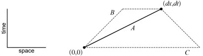

For a timelike geodesic, in the case of special relativity, it is easy to see that ##\int ds## is a maximum by considering nearby paths with zig-zag trajectories resembling forward light cones, whose proper time can be made arbitrarily small; see the picture below (left). This argument generalizes instantly to general relativity since, again, any trajectory has an arbitrarily close variation approximated by a light-like path, with arbitrarily small ##\int ds##.
For a spacelike geodesic, in the case of special relativity, it is again easy to see that ##\int \sqrt{-ds^2}## is a minimum by considering nearby paths that make the integral arbitrarily large. This is obvious in special relativity where (in Cartesian coordinates) ##g_{mn} = -\delta_{mn}## since then $$\sqrt{-ds^2} = \sqrt{dx^2 + dy^2 +dz^2 - dt^2} \,\, .$$ The picture below (right) illustrates a variation that increases ##\int \sqrt{-ds^2}##.
The question is: how does this generalize to curved spacetime? Now we have $$\sqrt{-ds^2} = \sqrt{-g_{\mu\nu} dx^\mu dx^\nu}$$ and it is not immediately obvious that if ##z(\lambda)## is a geodesic between ##P## and ##Q##, then any variation ##\bar{z}(\lambda)## of the geodesic will have a larger value of ##\sqrt{-ds^2} = \sqrt{-g_{\mu\nu} dx^\mu dx^\nu}##.
Spacelike geodesics are a saddle point of the variation. You can see that they are neither minimum nor maximum quite trivially in SR. Consider a geodesic in xy plane in standard Minkowski coordinates. Specifically take it as a segment of the x axis. Then a nearby spacelike path in the xy plane is longer in interval, but a nearby spacelike path in the xt plane will be shorter in interval.

Let the displacement A be along a spacelike geodesic. Then ##-ds^2_A=dx^2-dt^2##. Note that ##-ds^2_B=(dx-dt)^2## and ##-ds^2_C=(dx+dt)^2##. Hence, ##-ds^2_A## is not extremal.

Yes of course I meant 1 spatial dimension. This is clear from the picture I posted.

Sorry, I see now. So, in GR, neither timelike nor spacelike geodesics are local extrema. That's interesting.
No, in GR, some timelike geodesics are saddle points and some are local maxima. The usual case is that for sufficiently close points, where one is in the future of the other, there will be a unique timelike geodesic that is a local maximum. For points not so close, there will often be more than one geodesic, and one of them will be local maximum (in realistic cases, it will also be a global maximum).
  • #48
PAllen said:
@Orodruin already gave an example on a sphere where there are two geodesic paths between two points, only one of which is minimal.
Actually I believe it was @martinbn who gave the example of the sphere in post #10.
  • #49
Orodruin said:
Without loss of generality, go to the frame where the events occur at the same spatial point. The proper time for any curve between the points is then
\tau = \int_{t_0}^{t_1} \sqrt{1 - \dot x(t)^2} dt \leq t_1 - t_0$$ with equality if ane only if ##\dot x(t) = 0## for all ##t##.
Edit: The further restriction is that ##x(t_1) = x(t_0)##.
Simpler than what I was starting to write up - what I know of as the Legendre condition distinguishing whether you have a possible local minimum versus a possible local maximum for a variation.
  • #50
Kostik said:
Can you explain descriptively how to vary these two timelike geodesics (the orbital and the ballistic ones) to make ##\int ds = \int \sqrt{g_{\mu\nu}dx^\mu dx^\nu}## larger and smaller? It's hard to visualize.
More specifically, we can assume the metric is $$ds^2 = (1-2m/r)dt^2 - (1-2m/r)^{-1}dr^2 - r^2d\theta^2 - r^2\sin^2\theta d\phi^2 \,.$$ Can you describe how to vary the geodesics (orbits) to make ##\int ds## larger and smaller?
In accord with @PAllen's observation in #23 , I think we can slightly generalize @Orodruin's example here to show that the orbital geodesic is a saddle for angles larger than ##\pi##.
To do so, note that the orbital geodesic at the equator ##\theta=\frac \pi 2## and at constant ##r=R## can be parametrized by ##\phi##. So if we take varied paths with the same form $$\theta(\phi) = \frac \pi 2 + \eta f(\phi)$$we get $$\tau[\theta(\phi)] = \int_0^{a\pi} \sqrt{\left(1-\frac{2m}{R}\right)\left(\frac{dt}{d\phi}\right)^2 -R^2 \eta^2 f'(\phi)^2-R^2 \cos^2(\eta f(\phi))} ~d\phi$$Since ##\frac{dt}{d\phi}## is constant, the first and second derivatives of ##\tau[\theta(\phi)]## wrt ##\eta## when evaluated at ##\eta=0##, are proportional to @Orodruin's, and the same further reasoning applies.
