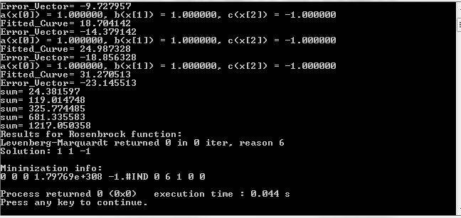

Hey, So I am trying to get my function now to match the style of the function being solved in levmar.c
The supplied function as the example is:
Code:
void ros(double *p, double *x, int m, int n, void *data)
register int i;
  for(i=0; i<n; ++i)
    x[i]=((1.0-p[0])*(1.0-p[0]) + ROSD*(p[1]-p[0]*p[0])*(p[1]-p[0]*p[0]));
My function is:
Code:
static double function(double *p, double *sum, int m, int n, void *data)
    double Fitted_Curve[5] = {0};
    double Error_Vector[5] = {0};
    int i;
    double a, b, c;
    sum = 0;
//    double  v1[5], v2[5], geom_inv[5], norm = 0, norm_2 = 0, v2sum = 0, x_coeff = 0;
//    Actual_Output[5] = {1.2, 2.693, 4.325, 6.131, 8.125};
   // printf("Actual_Output[0[ = %f", Actual_Output[0]);
a = p[0];//parameters
b=p[1];
c=p[2];
  for (i = 0; i <= 4; i++)
    Fitted_Curve[i] = (1/(a*b))*(c-asinh(sinh(c)*exp(a*Input[i]*2*pi)));
    Error_Vector[i] = Actual_Output[i]-Fitted_Curve[i];
    printf("a(x[0]) = %f, b(x[1]) = %f, c(x[2]) = %f\n",p[0], p[1], p[2]);
    printf("Fitted_Curve= %f\n", Fitted_Curve[i]);
    printf("Error_Vector= %f\n", Error_Vector[i]);
        sum = sum + pow(Error_Vector[i],2);
        printf("sum= %f\n", sum);
    a_global = a;
    b_global = b;
//    x_coeff_global = x_coeff;
    return sum;
p is the vector of my parameters, n and m at the moment I can't tell why there are two of them because I can't find the function that seems to solve the problem - although it runs, but between n and m, I think they state the number of parameters being solved.
I can't find any definition of data, but my problem is that the demo code doesn't have a return - it returns the array x[]. However I am trying to minimize the sum of the errors squared, so I want to return sum (I think), however I am not sure how to adjust the function so that I can do this. Did that make sense?
I have attached the output - It seems to only somplete one iteration, but I am not sure it knows I want to minimize sum?

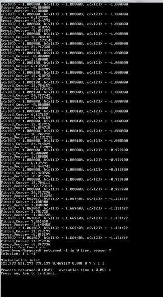

  • #56
How did you call the dlevmar_dif() function? Which parameters?
In your case m=3 (3 parameters).
And n=1 (your result vector only contains your sse/sum).
For now, I'd call dlevmar_dif() with opts=NULL.
The void* adata parameter looks like the common way to pass custom-data to your function. This should also be a parameter to dlevmar_dif() that does not do anything except pass the parameter to your function.
I guess you don't need this (yet).
What is this "minimization info" that you're displaying?
I can tell you that "-1#.IND" represents "not-a-number", meaning that an calculation was done that is invalid (such as taking the power of a negative number).
And what does the "reason 6" mean?

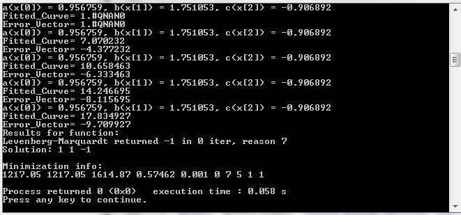

Cool thanks for that. It fixed all the so far known issues. Check image - says completed no iterations - due to reason 7 (I need to find that). I have set m to 3 as that is what it was before.
Edit: found reason 7 on website:
7 - stopped by invalid (i.e. NaN or Inf) "func" values; a user error
The minimizing error:

  • #61
According to the web page:
reason 7 = stopped by invalid (i.e. NaN or Inf) "func" values; a user error
return value -1 = no iterations performed.
As you can see you have a Fitted_Curve of 1#.QNAN0, meaning your calculation failed.
You're somehow feeding your function data that it can't calculate.
I see no reason for that, so I think you made a programming error.
Can you show your function as it is now, and also the values you're feeding it, and the Fitted_Curve/Error_Vector results, when it gives the 1#.QNAN0?
Note that the only possible reason that you might not be able to calculate the result, is if you have either parameter a or b given as zero.

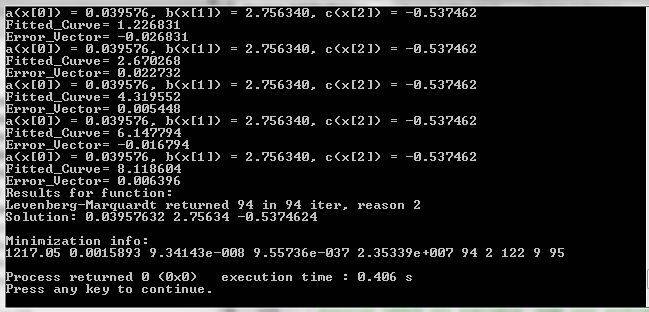

  • #64
I just changed the prototype to void, and initialised infor to zero's by putting it equal to {0}.
It runs much more succesfully now - 174 iterations, but stops due to reason 2 - stopped by small Dp.
The solution isn't correct though.
I have two warnings from GCC Compiler now, but both are generated due to warnings within the code such as
#warning LAPACK not available, some test problems cannot be used.
p[0] should = 0.025
p[1] should = 1.8944
p[2] should = -0.369
The solution it has found I think is the solution from when I was using neldermead. Now I am questioning the function
  • #65

I believe an Input[0] value of 0, yields a Fitted_Curve of 0, but that was never in your output before.
Btw, it has to be a different solution than the one from Nelder-Mead.
It reports an SSE=0.0015893 which is even more accurate than what you got from Matlab!
What do you get with the Input[] array of {1,2,3,4,5}?
And if you want even more accurate results, you should use dlevmar_der() with the Jacobian specified.
