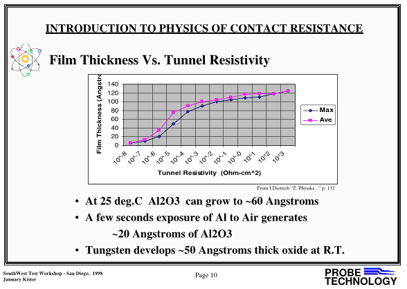

I have found a couple of papers on this, one I seem to have lost which appeared authoritative, but this one agreed with the basic figures
241003
What I am trying to get at is if I go to the metal store, buy two plates of aluminium, clamp them together firmly and attempt to pass 1000A through them, I'm not going to expect to find that they are insulated from each other.
My question is what resistance will I find if, say, I turn up a 1000A power supply, across them, to the max and I have created a 100cm^2 contact area between the two pieces?
The graph above suggests the resistance will be 10^-7 Ohm, after exposure to air, so the voltage between the pieces will be 1mV. Is that correct?

I've never ever known two pieces of aluminium to present electrical isolation when held together. I never got the impression it was 'luck' that they conducted. The graph I have shown indicates 60 Angstroms of thickness builds in atmosphere, and that a current will tunnel through that.
The sorts of dielectric layers that may be put in place in certain applications I have to presume are deliberately formed from thicker layers. I notice on that graph once above 120 Angstroms then it starts flattening out, so I presume there is a thickness that will be insulating, but doesn't seem to form from air.
