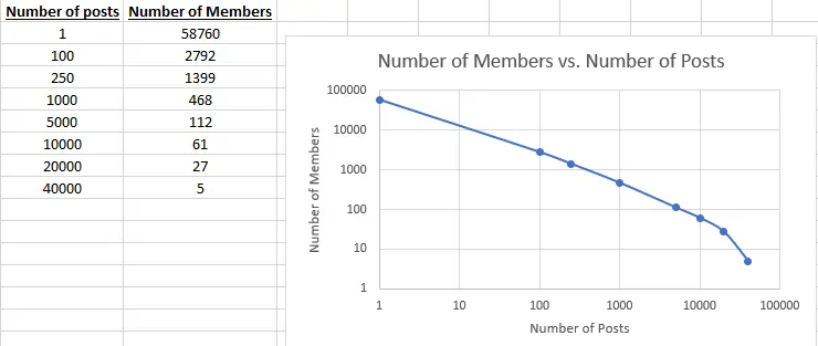

Hey guys. I modeled the distribution of PF post trophies using Wolframalpha.com. The formula is 58757.3/x^0.669229 with a fit of 0.999988. It slightly breaks down when the numbers get high.
( data from: https://www.physicsforums.com/members/?key=most_messages )

I have a problem with this formula. ##M(x)## is convex, and your graph is concave.
The graph is log plotted.

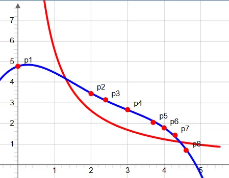

The plot seems correct by comparison with your list. I fed https://elsenaju.eu/Calculator/online-curve-fit.htm with your data to ##\log_{10}## on both scales. It also produces a power law with the wrong curvature: $$M=5.583 x^{−1.09}\quad\text{red}$$
But the polynomial (degree ##4##) has a good fit:
M= -0.046x^4+0.418x^3-1.276x^2+0.597x+4.769 \quad\text{blue}
Here is the file that I used:

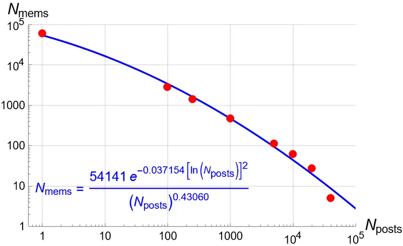

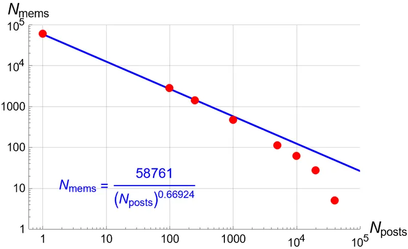

Hmm, I'm not seeing that. The formula for ##M(x)## is a simple power law and is thus linear on a log-log graph:
And the fit can be significantly improved by introducing a term quadratic in ##\text{ln}(x)##:

The plot in post #1 is clockwise bent, and ##y=x^{-2/3}## anticlockwise. If we take the log then ##\log y=-\dfrac{2}{3}\log x## which is linear, still not curved like the plot is. I first considered only the original function, and then mistakenly took only the log on one scale.
