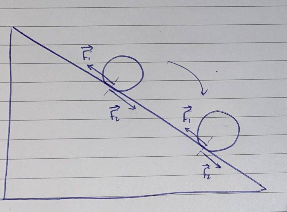

Suppose we consider the case of a block sliding down a rough wedge, which is fixed to the Earth. Treating the whole Earth-wedge-block system gives something along the lines of ##U_{1} = U_{2} + T_{block} + E_{th}##.
There are essentially two options, either the wedge gains all of this thermal energy, or it is split between the wedge and the block. If the block is specified to be rigid, the former applies and we might then say that ##E_{th} = f_{k}d## if ##f_{k}## is the frictional force applied by the block on the wedge. If not, I'm not entirely sure how it's possible to solve for the final velocity of the block.
My guess is that it is assumed in any mechanics problem that the quote-and-quote "main" object in the question is rigid (in this example, the block), and all of this thermal energy is dissipated in other components. I wondered whether anyone could think of any exceptions? On perhaps another level, does it matter/make any difference to the answer where this thermal energy is dissipated? I'm inclined to say yes, simply because I don't believe there is any way of computing ##E_{th}## unless it ends up in one body only.

Why only the wedge? The model says nothing about where the dissipated energy goes to.

Possibly one interesting detail that as come out of this is: If we let the second object move, then the frictional force accelerates it (no loss of energy directly). But, the force decelerates the incoming object (which is where the energy loss comes from).
If you imagine the friction with the wedge accelerating the wedge-Earth a tiny amount, then that interaction incurs no energy loss. That's why you don't double count the friction force and get twice the energy loss.

No, because the displacement is different for the two contact patches, if they are in relative motion (sliding).
Likes etotheipi
I'm not sure I follow. We might consider making the block arbitrarily small, the point of application of both frictional forces (block on wedge and wedge on block) would be the same point. Then the displacements of both forces should be equal.
No, the displacements are different, because the physical points of force application (the material parts of each body were the force is applied) are moving relative to each other.
I've realized I've drawn cylinders instead of a block (please ignore this part, I didn't intend for any rolling, just sliding!). Though I can't see why the two displacements would be any different.
  • #31
Displacements are integrals of velocity, but you can also consider the velocities and thus the instantaneous power, instead of work. Since the velocities of the contact patches are different, the equal but opposite kinetic friction forces are not doing equal but opposite work/time (power). The discrepancy represents the dissipated energy.
Likes etotheipi
  • #32
I might need to come back to this in the morning in the case that I'm missing something obvious since it seems I'm stuck in a bit of a pantomime-style "Oh yes it is!", "Oh no it isn't!" situation, but I really struggling to figure this out.
To me it seems there is only one common point of contact between our arbitrarily small block and the wedge, and the velocity of the contact point is obviously equal to the velocity of the block. At all points in the motion, the two opposite frictional forces act at the same point (the contact point). Both undergo the same displacement by a vector ##\vec{d}## as measured in the Earth frame in which the wedge is fixed.
I do apologise if I'm missing the point!
  • #33
The work done by wedge on block is determined by the force of wedge on block multiplied by the motion of the block material at the contact point.
The work done by block on wedge is determined by the force of block on wedge multiplied by the motion of the wedge material at the contact point.
The forces are equal and opposite, of course. That's Newton's third law. But no matter what frame of reference we choose, the motion of the block material and the motion of the wedge material at the contact point will differ. Otherwise we are not dealing with kinetic friction.
[One should draw sliding objects as rectangles rather than as circles to avoid the implication that rolling and static friction are involved]
Likes russ_watters
  • #34
Ah, okay. I was working under the assumption that work done by a force in a certain frame of reference was the dot product of the force and the displacement of the point of application of the force.
The two bodies are certainly in relative motion. Though the work done as calculated by the definition I gave as opposed to the ##P = \vec{F} \cdot \vec{v}## calculation are then apparently different. I don't understand how this can be the case.
  • #35
Indeed, that is a common misunderstanding. It is the displacement of the target material at the point of application that matters.
The point of application cannot be in a fixed position relative to both of two slipping surfaces.
Likes etotheipi
