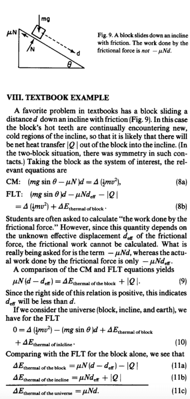

Right, sure. So I suppose the conclusion is that we can't find the final KE of a non-rigid block if we consider the block as a single system.
Whilst we can if we take the wedge-block system and note that the change in thermal energy is the negative of the total work done by internal kinetic frictional forces.
The algebra's a bit weird though. For the block-wedge system
##mgh = \Delta T + \Delta E_{th} = \Delta T + f_k d##
But for the block and wedge individually,
Block: ##mgh - f_{k}d = \Delta T + \Delta E_{th, block}##
Wedge ##0 = \Delta E_{th, wedge}##
Since the two models have to be consistent, we can only then conclude that ##\Delta E_{th, block} = 0##. That can't be right, though, since we've somehow determined that the change in thermal energy of the block + the wedge is zero, whilst we know it to be ##f_k d##.

I meant to say that it would count, though in this scenario it reduces to the centre of mass kinetic energy.
Centre-of-mass work would certainly work here.
##mgh - f_k d = \frac{1}{2}mv^{2}##
But now if I use the first law of thermodynamics,
##mgh - f_k d = \frac{1}{2}mv^{2} + \Delta E_{th}##
This is what's causing the problems, we're left with this bizarre ##\Delta E_{th}## left over if we consider thermodynamic work. This must turn out to be zero. Though the thermal energy of the wedge is also zero if we consider it as a system.
So something has to be wrong! I'm thinking that it has something to do with thermodynamic work vs centre of mass work. In the limiting case that the mass becomes a point particle, it has no thermal energy and both expressions are the same.
But if we scale it up to a fullsize block, either ##f_k## or ##d## has to decrease.

Center of mass work does not conserve energy. It's not about conservation of energy. It's about motion of the center of mass. The problem you wanted to solve wasn't about energy. You just wanted to know about the motion of the center of mass. And you ended up knowing the motion of the center of mass.
Why are you complaining that you didn't get total energy when you didn't ask for total energy?

Your second equation is wrong. The friction and thermodynamic work terms are the same thing with different labels. It's double-counted.
It might help if you arrange the first equation as a before and after or input and output.
Likes etotheipi
  • #59
I think you're right, but I can't exactly determine why. The goal is to determine the final KE of the block using only a system which contains only the block.
I'll define the system to be the block. Initially, ##E = T_1 + {E_{th, block}}_1 = 0 + 0 = 0##, since I'll say it starts at rest with no thermal energy.
