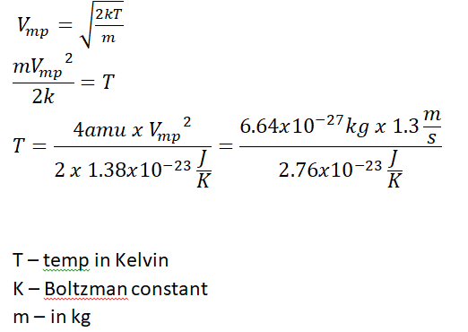

Vmp= sqrt(2kT/m)
Can someone explain to me what I am doing wrong? Trying to calculate the Temperature T using this formula
I am trying to find T using most probable speed of atoms formula.

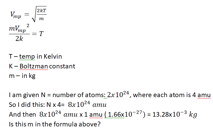

T = (V^2) m/( 2k) I am getting riduculous T like 20x10^27. Why?
If number of atoms N= 2x10^24 how do i get mass m? each hellium atom has 4 amu.
What i get is this : 2x10^24 x 4 = 8x10^24 amu
then 8x10^24 x 1.66x 10^-27 = 13.28x10^-3= m
is that correct?
It is unclear to me hiw you are computing T as you have not provided details here. Regarding your mass computation, please make sure to quote the appropriate units everywhere. You are probably using units of kg, but it is not very clear (and technically incorrect) to not quote the units.
Edit: Are you using the mass of the entire helium gas when computing T? The mass that goes into the formula is the atomic mass, not the mass of the entire gas.

Hmm... so what do i do with N- number of atoms? Yes, that was my intention. total mass of gas.
Should I just then make m=4 to find T since helium is 4 amu?
You cannot use the number of atoms to find the mass of one atom. You are not given the total mass of the gas, are you? You are told that the gas is helium and this is how you find the molar mass or the mass of an atom, whicever you want to use.

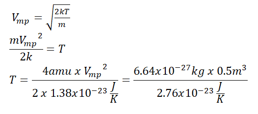

You have a volume of ##0.5m^3## in your formula. Where is that from?
The most probable speed should appear in your formula - it doesn't.
So I would say the formula is incorrect.
To convert 4amu to kg you multiply it by ##1.66 \times 10^{-27}## kg/amu. So yes, that part is correct.

Apologies. I messed up with the formula above.
The Volume V = 0.5 m^3

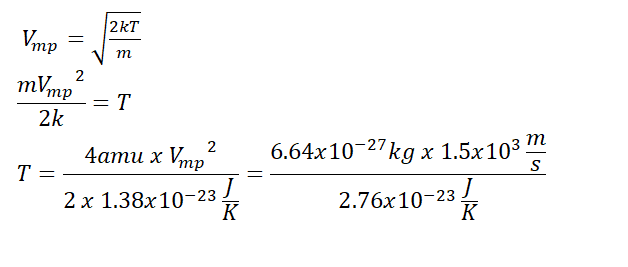

And the most probable speed Vmp = 1.5x10^3m/s.
So how to I get T in Kelvin? None of the units cancel so whatever is left we call it Kelvin then?

You have forgotten to square the most probable speed.
All your quantities are SI. So if you do the calculation (with correct values!) the answer will automatically be in kelvin (upper-case 'K' for the symbol, lower-case 'kelvin' for the full name).
If you want to confirm that you have the units correct, you can express a joule in terms of kg, m and s. A joule is a derived unit (a combination of base units).
