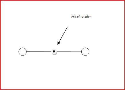

So the moment of inertia or a ring is MR2 I don't understand why. Here is my reasoning
Consider this shape (the ball is a point), the moment of inertia is MR2, there I agree
but now
what happens when you add another point on the other side
since I = ΣMR2 then this is 2MR2
What about a ring or circle, that is nothing more than a bunch of points all the same distance from the center
so how many points are there? The circumference
so I= πR2MR2
I know that different objects moment of inertia differ by a number in front, like 1/2 or 3/5
Why is their no number prefix for Inertia in front of the formula for a hoop/ hollow cylinder/ circle that represents its circumference? How is this even derived?
Second question, How do you represent the angular Kinetic energy of this object?
You have two point-like balls of mass M at distance R. That's a total mass of M=2M. I = MR2.
but what about R, isn't their as many R's as there are points? Then where do the numbers in front of them moment of inertia come from? I how do you derive the MoI of a circle? Is my way correct? What about the second question?
For a collection mass or masses all at the same distance from the circle the "R" is the same for all.
For the second question... Just what is your second question?

First label individually...(assuming a common axis of rotation)
Particle A has rotational-KE: ##K_{rot,A}=\frac{1}{2}I_A \omega_A^2=\frac{1}{2}(m_Ar_A^2) \omega_A^2##
Particle B has rotational-KE: ##K_{rot,B}=\frac{1}{2}I_B \omega_B^2=\frac{1}{2}(m_Br_B^2) \omega_B^2##
The rotational-KE of the system ##K_{rot}=K_{rot,A}+K_{rot,B}##
Since the system is rigidly rotating, ##\omega_A=\omega_B## (simply call them ##\omega##).
I'm sure you can complete the story.
[tex]I = \int r^2 dm[/tex]
source: https://en.wikipedia.org/wiki/Moment_of_inertia
David112234 said:
Is my way correct?
Of course. You are using the sum instead of the integral, which is correct for a simple case:
[tex]I = \sum r^2\Delta m = r_A^2 m_A + r_B^2 m_B[/tex]
if [itex]r_A = r_B = r[/itex] and [itex]m_A + m_B = m[/itex], then:
[tex]I = mr^2[/tex]
Same thing:
[tex]E = E_A + E_B = \frac{1}{2}I_A \omega_A^2 + \frac{1}{2}I_B \omega_B^2 = \frac{1}{2}r_A^2 m_A \omega_A^2 + \frac{1}{2}r_B^2 m_B \omega_B^2[/tex]
if [itex]r_A = r_B = r[/itex], [itex]m_A + m_B = m[/itex] and [itex]\omega_A= \omega_B= \omega[/itex], then:
[tex]E = \frac{1}{2}mr^2 \omega^2 = \frac{1}{2}I \omega^2[/tex]
where [itex]I = mr^2 = I_A + I_B[/itex]
Likes David112234
