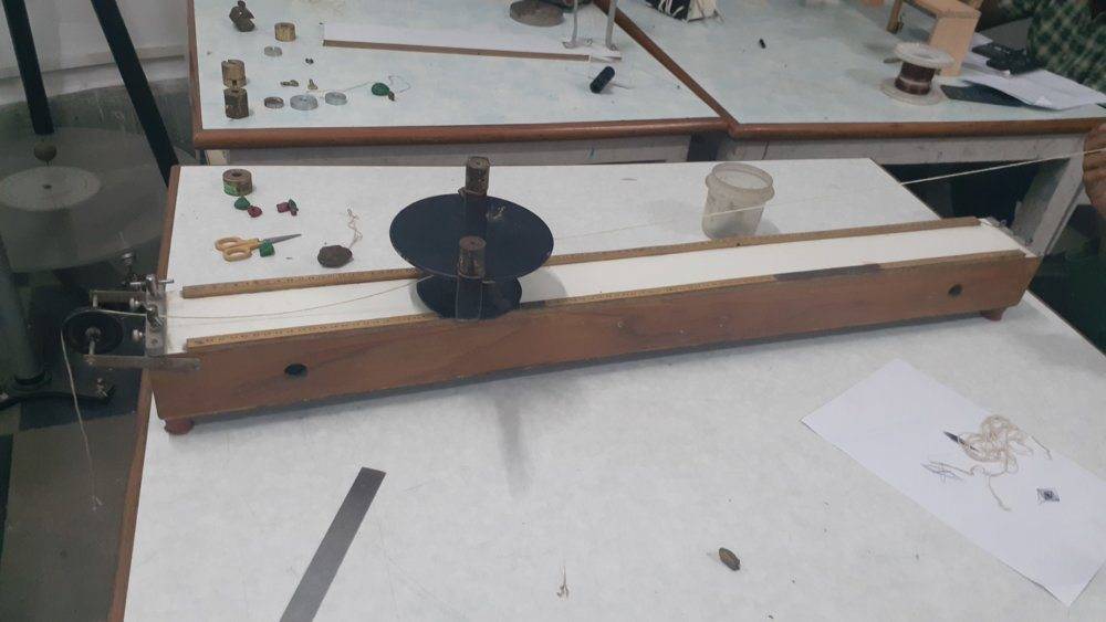

So in the above image, I intend to find the moment of inertia of that black rotating object which rotates due to torque which is provided by placing mass on the pulley.
But the thing is that this rotating object is kind of like a ball bearing kind of system and even for a small torque it starts to rotate.
So is there any other things I can do with this experimental setup, like finding relationships among different physical quantities, or approximating the error on this ball bearing system, etc...
Any ideas please do post
Thanks in advance!

Ok so till now I have found the angular acceleration and from that I intend to find the Moment of inertia by equating it to mg×r
But it's here when I realized that my angular acceleration could be affected by this ball bearing system and my value might be less.
So yeah If possible please solve this first

Ok let me explain clearly...
My aim is to find the moment of inertia of the black rotating object(kind of like a flywheel)
So as you can see in the previous apparatus pic, there's a string which goes from the spool of thread to this black rotating object and towards the pulley where we can suspend mass so as to rotate this black object
So we know that torque is equal to R×F.
F is given by mg, where m is the mass suspended by the pulley. And R is the radius of the rotating platform
Torque is also equal to I times angular acceleration, where I is the moment of inertia.
We can find angular acceleration by calculating the time period of rotation. And now, with all the requirements, I can go ahead and equate the two expressions for torque.
But the problem here is that since this is a ball bearing system, it tends to rotate "easily" even for small amount of torque.
So how can I get over this issue? Can I approximate the error of this ball bearings?
Or is there any flaw in my description? Pls let me know
Thanks

@VVS2000 It would not be too difficult to measure the dimensions of your flywheel and also to have an idea what the material is (hence, the density). You can then use the MI formula in your lesson notes (or whatever). It isn't clear which are the massive bits but it looks as though you need to include both the two discs, the cylinder and the 'lumps' on the top of it; the MI will be the sum of the separate MIs. (Make up a table and add the four(?) contributions at the bottom.)
I thought you want to measure it. One way is my proposal in #10, if I understand your vague description of the setup right ;-).
Hello again, @VVS2000
I see a lot of reactions to the tune of "what is going on here" and I must agree that the two pictures do not constitute a useful description of the experimental setup.

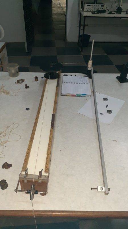

  • We see that the black contraption has moved between pic 1 and 2, so apparently is isn't bolted to the track.
  • We see a spool with thread in pic 1 , which may or may not move with the black object on its own track ? In pic 2 the spool is replaced by a hand, which should severely ruin any chance of reproducible measurement.
  • We see little cylinders
    on the disc that are not explained. Are they replacable weights to vary the moment of inertia ?
Please come up with a full description. If this is a lab exercise, also post the complete instructions.
And if a helper asks a question, answer it. We do want to help but you have to help us help you !

I am really sorry for all the ambiguities.
As for those cylinders, yes you can remove them.
And no, this is'nt a lab exercise. I am just working with what is available in my physics lab.
The spool exists in both the pictures. There is no other person holding it.
Plz tell what and all confusions you have about this setup.

Own in the sense won't it rotate like there's something external other than the torque by the suspended mass is acting on it?
What does Newton's first law say about objects that are subject to no external forces?
VVS2000 said:
No, I don't!
I am just doing experiments to figure things out which seems interesting
Let's go back to basics. You say you don't have a procedure yet you are "just doing experiments to figure things out". That is commendable but you need to have some idea of what you are trying to figure out so you can design and control your experiment in a way that will help you draw sensible conclusions. For example, Galileo wondered if heavier objects fall faster. So, he and an assistant dropped two balls of different weights from the tower of Pisa and saw which ball hit the ground first. That was their procedure motivated by the question "Which ball hits the ground first?" Humanity knew for centuries before Galileo that if you release an object it falls; that a heavy mass falling on you hurts more than a light mass falling from the same height; and that the higher the speed of a moving the more it hurts. What Galileo wanted to sort out was "does the heavier mass falling on you hurt more because it is moving faster or because of some other reason?"
The same applies here. Just observing your contraption do its thing without a question and a path to reaching the answer of that question will not buy you understanding.
  • #31
Sry I did'nt understand. Can you tell it in a diff way?
  • #32
Well yeah you're right. My aim is to try and find the moment of inertia of that object. But what I meant to say was I was'nt working on this experiment strictly based on a procedure. I did a similar experiment last semester and I just wanted to apply the same method or technique for this setup for finding the same thing
  • #33
We can help you do that. What was the experiment you did and how did you do it?
  • #34
Newton's first law:
"An object at rest stays at rest and an object in motion stays in motion with the same speed and in the same direction unless acted upon by an unbalanced force."
What does the above law say about the motion of an object that begins at rest and is subject to no forces?
It's not a trick question. It is a simple question intended to make you stop and think. But you have to actually answer it.
