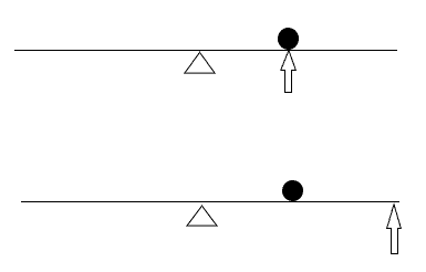

The formula for moment of inertia is:
I=mr^2
A common derivation for this is:
1. F=ma
2. τ=rma
3. τ=rmrα = r^2 mα
This is a rotational version of Newton’s second law, where torque replaces force, moment of inertia replaces mass, and angular acceleration replaces tangential acceleration.
What bothers me is that the two rs in the formula refer to two different things: the r derived from torque (line 2) refers to the position where the force is acting; the r derived from angular acceleration (line 3) refers to the position of the mass. But what if the force is not acting on the same place as the mass? For example, what if a mass is placed on at point r from the pivot point, but the torque is applied at 2r from the pivot point. Does it have the same formula for its moment of inertia?
The derivation models the rigid body as a collection of point masses, which all have the force needed for their tangential acceleration applied directly to them (for example via internal forces of the body). That's what the F stands for here. Applying F somewhere else doesn't make sense in this model, because then equation 1 cannot be used to relate F and the tangential acceleration.

That's because torque relates to work, while Newton's second law doesn't. The moment of inertia depends on both concepts. For Newton's second law it doesn't matter where you apply the force. For work it does, because you can do more work if you use a lever, for example. And when you have a lever, you can put the mass (which can be a point mass, for simplicity's sake) at the end of the lever - where you apply the torque, or closer to the pivot point of the lever.
chananyag said:
The moment of inertia depends on both concepts. .
I am not sure which two concepts you mean here (Torque and Work??) but the MoI of a body doesn't depend on anything except the density of the body, the geometry of the body and where we put the axis of rotation (and all these should be clear from the formula I gave). For a point particle of mass m, its MoI is always ##I=mr^2## where r is the distance from the axis of rotation.
Here you introduce the concept of a lever. I am sure you have in your mind an ideal lever that has no mass and no moment of inertia, but real levers have both and we must take those into consideration when we consider the dynamics of a system with a lever.
The moment of inertia of a point mass will still be ##I=mr^2## even if we put the point mass on an ideal lever. The moment of inertia of the system (point mass+lever) will be different depending on where is the axis of rotation and where we put the point mass.

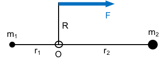

Perhaps the following example illustrating what @A.T. said in post #2 will help you understand how this works by addressing your "what if" question.
Two masses ##m_1## and ##m_2## are connected by a light rod. A second light rod of length ##R## is welded at right angles to the first rod and the assembly is pivoted at point O as shown in the figure. Force ##F## is applied. Find the torque acting on each mass.
Solution
The moment of inertia of the assembly about O is ##I=(m_1r_1^2+m_2 r_2^2)##.
The torque on the assembly about O is ##\tau=FR##.
Newton's Second law says ##\tau=I\alpha##.
Therefore the common angular acceleration of the two masses is ##\alpha =\dfrac{\tau}{I}=\dfrac{FR}{(m_1r_1^2+m_2 r_2^2)}##.
The linear acceleration of mass 1 is ##a_1=\alpha r_1=\dfrac{FRr_1}{(m_1r_1^2+m_2 r_2^2)}##.
The net force on mass 1 is ##F_{1}=m_1a_1=\dfrac{FRm_1r_1}{(m_1r_1^2+m_2 r_2^2)}##.
The net torque on mass 1 about O is ##\tau_1=F_{1}r_1=\dfrac{FRm_1r_1^2}{(m_1r_1^2+m_2 r_2^2)}##.
Likewise, the net force on mass 2 is ##F_{2}=m_2a_2=\dfrac{FRm_2r_2}{(m_1r_1^2+m_2 r_2^2)}## and the net torque is
##\tau_2=F_{2}r_2=\dfrac{FRm_2r_2^2}{(m_1r_1^2+m_2 r_2^2)}##.
Note that ##\tau_1+\tau_2=FR## as it should. It should be clear now how the different position vectors enter the calculation and how the external torque on the rigid body is divided between individual torques acting on each mass. These ideas can be extended the same way if you add a third, fourth or any number of masses.
This example is great. I thought I might add one extra thing just to put it in context with what I wrote above. The torques ##\tau_1## and ##\tau_2## are internal torques exerted by the frame on the two masses respectively, and by Newton III the two masses exert opposite torques of magnitude ##\tau_1## and ##\tau_2## back on the frame. This is also justification for why ##\tau_1 + \tau_2 = FR##, since it is a statement of balancing torques on the the system consisting of the frame without the two masses.

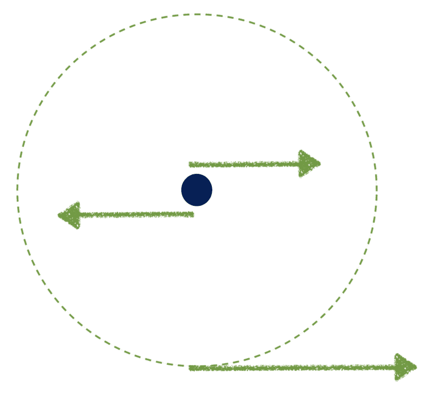

I would like you to consider that the torque of the formula has a value that corresponds to many possible combinations of tangential force(s) and distance(s) to the axis of rotation of the mass.
A torque steadily applied ("how" is not important, "where" does not make sense) in a perpendicular way to the axis of a rotational mass (punctual, multiple or distributed) will induce a steady angular acceleration/deceleration.
For convenience and simplicity, we apply the tangential force onto the mass for a single-mass rotational system.
As you have described, the tangential force could be applied anywhere along the imaginary line that connects the mass and its axis of rotation.
If we want to use the radial location of the mass, then we assume that an imaginary force applied there induces the same value of torque than the actual force that is applied somewhere along our imaginary line.
Note that neither the actual nor the imaginary force appears in the formula.
Besides the square of the radius of gyration of the mass, what is important for the value of the resistance of the system to accelerate or decelerate is the magnitude of the resultant torque value, not the magnitude of the tangential force(s) and distance(s) of application.
Here you can see a practical case, where the force than induces the torque is applied at a radius from the axis of rotation that has nothing to do with the radius in the formula of moment of inertia of a body with a peculiar shape:

chananyag said:
IThe second one has twice as much torque, twice as much rotational energy (so it seems to me), and therefore (so it seems it me) twice as much moment of inertia. The angular momentum, however, is the same for both.
The moment of inertia of this system remains the same (as long as we don't change the position of the point mass or the pivot point) regardless of where we apply the torque.
Likes Lnewqban and etotheipi

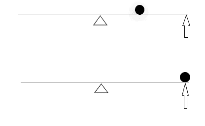

Would you make the same argument in this case? I'm not disagreeing with you, I'm just trying to flesh it out. Hopefully it'll make it clearer for me.
Assuming the plank is massless, then you have now quadrupled the moment of inertia of the system. You can work everything else out from that :smile:

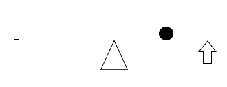

I think the OP has some misconception about moment of Inertia depending on where we apply the torque or how much torque or work is done. Moment of Inertia does not depend on torque or work done, it depends on the geometry of the body, its mass distribution along that geometry and where we put the axis of rotation.
chananyag said:
... Take the two examples illustrated below. The second one has twice as much torque, twice as much rotational energy (so it seems to me), and therefore (so it seems it me) twice as much moment of inertia. The angular momentum, however, is the same for both.
Can you see what is incorrect about those statements in this example?
Consider that the angular velocity has been reduced in half for the second case.
If your force is going to produce the same amount of work for both systems (as it should be in order to do a proper comparison) and if it remains perpendicular to the lever, the lengths of the arcs each describes must be the same.

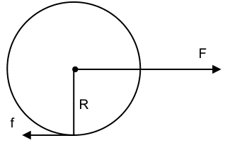

chananyag said:
For example, take two cars accelerating at the same rate, but one has smaller wheels. If I'm not mistaken, the cars will both be accelerating at the same rate, but the smaller wheels will be spinning faster (i.e. it will take them quicker to make a full circle). But in that case, the force is closer to the axis! The force of the friction from the road is closer to the axis because the wheels are smaller. This is why I still don't understand, intuitively at least, how torque arises from Newton's laws. I'm guessing I made a misstep somewhere, just trying to find it.
I think everything you said about the wheels is correct. For the same magnitude of acceleration of the car, the two friction forces must be of the same size (if the cars are of equal mass). The torque of the friction force about the axis for the larger wheel is also larger, for the same value of this acceleration. However, note that with a wheel being driven by an axle, it is the torque from the axle in the opposite direction to the torque of the friction force that is driving the angular acceleration in the same sense as the acceleration of the car (so the example is slightly more complicated than it seems!).
You could try working through the maths. By the rolling condition, you can first write ##r\alpha_1 = R\alpha_2##, where ##R>r## and go from there!

Sorry let me rephrase that. The derivation from F=ma doesn't explain why levers work. But then again, levers are useful because they perform more work with less force. So to explain levers I think you need the concept of work, but that doesn't mean you can't derive torque from F=ma.
  • #32
Hmm, suppose I have a massless see-saw type contraption with a hinge in the middle, and I put a mass on the end. I balance the torque of the mass on that end by exerting a force on the opposite end.
Now suppose I always exert a tiny bit more force than is required for equilibrium, so that the see-saw tilts and the mass rises, but with negligible acceleration, until the height of the mass increases by ##h##.
No matter where I apply this force on the other side of the see-saw, when the mass reaches the height ##h## I will have done the same amount of work on the system.
The reason why levers are useful is that I get to exert a lower force over a longer arc length if I push near the end. The total amount of work I do in this case to raise the height by ##h## is the same. Levers don’t create energy!
