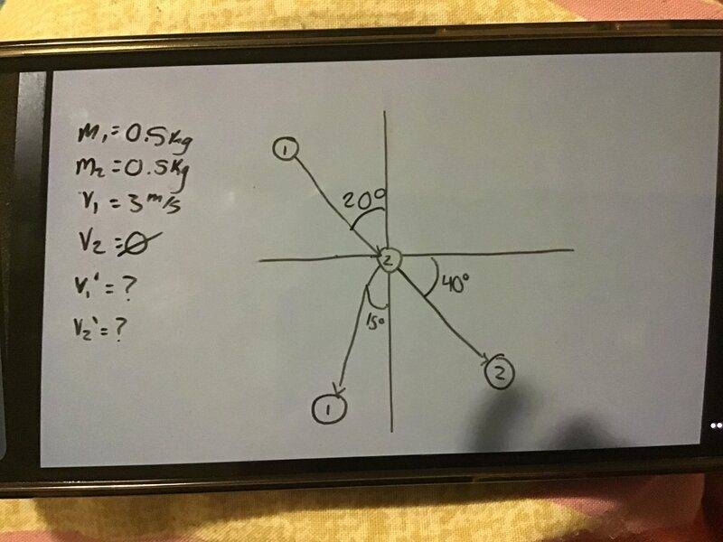

There is a situation in which M1=0.5kg, M2=0.5kg, V1 = 3m/s and V2=0. Find V1’ and V2’. I know we do component vectors and the we use the formula M1V1+M2v2=M1V1’+M2V2’ but I don’t know if we do perpendicular/parallel or vertical/horizontal and what we do with three angles?
Parallel:
(0.5)(3)+0=(0.5)(cos60)(3)+V2’Cos(x)(0.5)
V2’cos(x)=
Perpendicular:
0=(0.5)(0.3)(sin60)+V2’sin(x)(0.5)
V2’sin(x)=
And the divide 2 by 1
Which is tan(x)=2/1
And then plug then back into solve, but I don’t think we do it like this because we are only solving v2’ but we need v1’ as well?
Can you post this "situation" exactly as it was given to you? It's probably a 2D collision but we need to know whether energy is conserved or not. Yes, conservation of momentum is applicable here. Usually, the direction of the motion is chosen the x-axis, but your drawing seems to indicate otherwise. We need to see the question as was posed to you and not your own interpretation of it because sometimes the two differ.

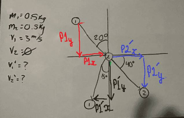

I would begin by rotating the whole system anti-clockwise 40 degrees so that the angle for post collision momentum of ##m_2## is zero.
And then I would draw a vector diagram showing ##\vec{p_1'}+\vec{p_2'}-\vec{p_1}=0##
This is all that was given to us - and the drawing was given to us like this with these angles and everything
Yes, I understand now. Thanks for the clarification.
neilparker62 said:
I would say KE not conserved since if it were the post collision trajectories of the two equal mass objects would be at right angles.

lola1227 said:
We’re supposed to do it using vector components (horizontal/vertical) or paralllel/perpendicular but I’m not sure what to do or how to start it.
Sum of components blue and black = red. Not the easiest way perhaps - but it should get you there.

lola1227 said:
So, would we use the parallel/perpendicular or the vertical/horizontal and would we have two unknowns and plug one unknown into the other to solve them?
That's the idea. Formally, you would draw all vectors as arrows with their tails at the origin and then figure out the components. What @neilparker62 shows in post #12 is correct but could be confusing to a beginner because, for example, p1x is placed on the negative axis, yet it is a positive quantity since its arrow points to the right.

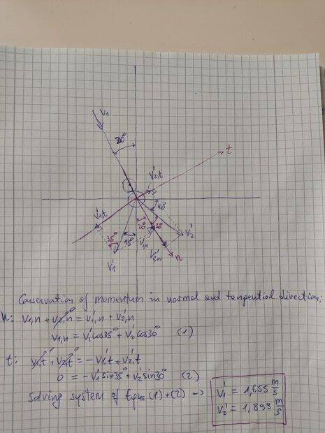

Here I have implemented post #6. Since ##|\vec{p_1}|## is known , ##|\vec{p_1'}|## and ##|\vec{p_2'}|## - hence ##|\vec{v_1}'|## and ##|\vec{v_2}'|## - can be calculated using the sine rule.
I introduce two new axis : the collision normal axis n and the contact tangential axis t . Note that the initial velocities of both particles in the t axes must be zero. I hope this helps.
