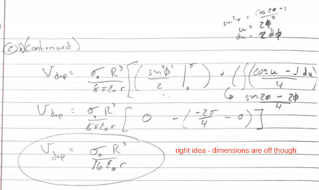

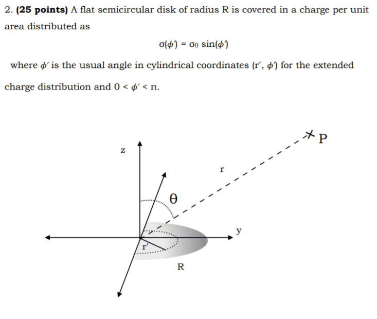

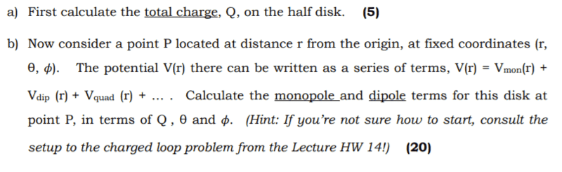

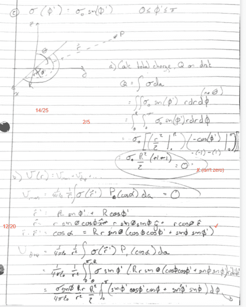

So this is from my last exam. I wanted to figure this out as we can get some credit back on a question plus finals are coming up.
On my attached attempt you can see the equations I use as well as a few of the professor's notes
Calculate potential on the z axis in terms of a Legendre polynomials. Then the off axis expansion will follow.
