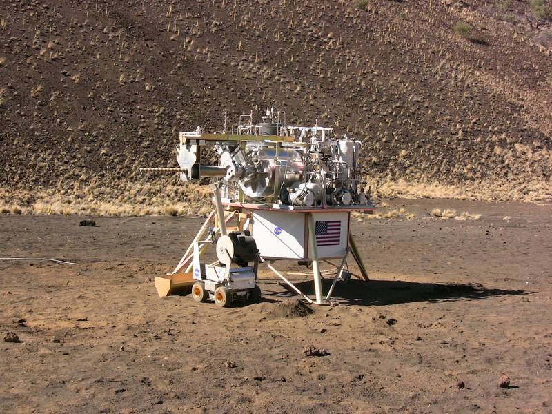

Here is a picture from 2012 of field tests Hawaii:
Oxygen production is certainly proven. We do not see a lot of commercial machinery that extracts oxygen from rocks. That is because oxygen is available from in an atmosphere everywhere on earth.
