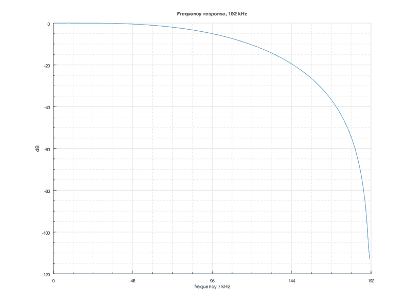

The conjectured reason (from the article DXD - Surprise) is 'Maybe the reason is because the filtering needed at lower sample rates becomes unnecessary when you get to 352.8 or 384 kHz'
Some filtering must be used to create the DXD file from the DSD file, but it can be so gentle and is at such a high frequency that it is like no filter at all:
https://media.ifi-audio.com/wp-content/uploads/2020/02/iFi-audio-Tech-Note-The-GTO-Filter.pdf
Such a filter at 352.8, while still a filter, for all practical purposes, does nothing in the audible range - it is just leaky and lets ultrasonic noise through (see the attached file for the 192k GTO filter response). It would be even better at doing nothing at 352.8
The suggested method requires just 'nothing' filtering to have lower sample rates, simply upsampling to get the ultrasonic noise below 16 bits and decimation.
The real issues with filters come at the DAC end. While decimation is simple, the upsampling filter to restore it to DXD sampling is more difficult. The upsampling filter in a product like HQ Player is one possibility.
