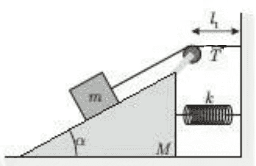

See the picture below. Initially, the system is at rest. Neglecting friction and mass of both spring and string,
a) what is initial acceleration of M? Assume initially the spring is at natural length ##L_1##
b) find the tension when the system moves for the first time
c) is total energy of system conserved?
d) after moving a distance ##x_o## towards the wall, M will stop. Find ##x_o##
e) find the equilibrium point of M, measured from initial position of M, when M oscillates
f) find the period of oscillation of system

a) When the system is in motion for the first time, the force causing ##M## to move is contact force with ##m## so:
$$\Sigma F=M.a$$
$$N \sin \alpha=M.a$$
$$mg \cos \alpha \sin \alpha =M.a$$
$$a=\frac{mg \cos \alpha \sin \alpha}{M}$$
Is that correct?
b) Is acceleration of ##m## the same as ##M## when the system moves for the first time?
Thanks
Are you sure N=mg cos(α)? If so, in which direction will m accelerate in the ground frame? Which direction is that relative to M?
Likes songoku
Based on free body diagram (taking x-axis parallel to the slope of inclined plane), I think so
With respect to ground frame, ##m## will accelerate down the plane and ##M## to the right. With respect to ##M##, I think ##m## will also accelerate down the slope.
Or maybe my imagination is wrong? Actually with respect to ground, ##m## is accelerating vertically downwards and with respect to ##M##, ##m## is accelerating down the plane?
Thanks

If you observe the geometry of the string, you could see that:
1) The length of the RH portion of the string is reduced in the same magnitude that M moves towards the right.
2) The length of the LH portion of the string is increased in the same magnitude that M moves towards the right (because of 1 above); therefore, m slides down the slope and away from the pulley respect to M.
I believe that, respect to the ground, m moves downwards and towards the left as the spring gets compressed.
There is a reaction at the axis of the pulley due to the tension of the string, but perhaps its horizontal component is not significant enough to include it in the solution of this problem.

Let me start again, laying out what I hope is a simpler path, working in scalars.
Let the acceleration of M be a.
Find a simple kinematic equation relating amw (which we know is parallel to the slope) to a.
Let the horizontal and vertical accelerations of m in the ground frame be ax, ay.
Write out the ΣF=ma equations in those directions. These will involve N, T and mg.
Write the horizontal ΣF=ma equation for M.
We need two more equations. These express ax, ay in terms of a, amw.
See how far you can get.

I gave you the hint to think about string length. If the wedge moves a distance x towards the wall, what happens to the length of string from the pulley to the mass?
Likes songoku
I tried to use that hint and also what Lnewqban posted in #16 but apparently I did not use it correctly.
When the wedge moves a distance x towards the wall, the pulley will also move as far as x towards the wall hence the length of string from the pulley to the wall decreases by x, so the length of string from the pulley to the mass increases by x since the total length should stay constant.
From there, I thought since ##a## is to the right and ##a_{mw}## is down the slope and the distance traveled by the mass and the wedge is the same, the magnitude of ##a## and ##a_{mw}## would be the same and I tried to find the component of ##a_{mw}## which is parallel to ##a##, hence ##a_{mw} \cos \alpha## directed to the left
Edit: Ah I see my mistake, ##|a|## is the same as ##|a_{mw}|## but is not the same as ##|a_{mw} \cos \alpha|## as ##|a_{mw} \cos \alpha|## will be less than ##a##
So the equation will be ##|a|=|a_{mw}|## ?
Thanks
Since ##a_m = a_{mw} + a## and for horizontal direction ##|a|> |a_{mw} \cos \alpha|##, I assume horizontally ##m## will move to the right with respect to the ground
∑F = m.ax
T cos α - N sin α = m.ax ...(1)
For vertical direction:
∑F = m.ay
mg - N cos α = m.ay ...(2)
∑F = M.a
N sin α = M.a ... (3)
ax = a - amw ... (4)
ay = amw sin α ... (5)
Is that correct?
Thanks
I don't think that follows. Remember that amw is down and left.
ΣF = m.ay
mg - N cos α - T sin α = m.ay ... (2)
amw has a vertical component.
ax = a - amw cos α ... (4)
After a lot of algebra, I find the acceleration of M:
$$a=\frac{mg \cos⁡ \alpha}{M(\cos \alpha \cot \alpha+ \sin⁡ \alpha)+m \sin \alpha}$$
For question (b), I just need to substitute a to previous equations

I agree with your answer for a, but it can be simplified. Multiply top and bottom as necessary to get rid of the cot.
d is quite easy if you just consider energy.
Likes songoku
I got:
$$a=\frac{\frac{1}{2}mg \sin 2 \alpha}{M+m (\sin \alpha)^2}$$

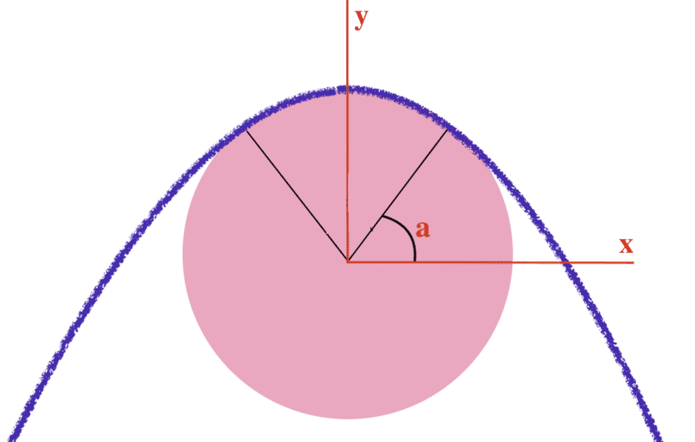

@TSny pointed out your error, but I'd like to provide a little more context just because in my experience pulleys are notoriously poorly explained in school.
Although this problem tells us to neglect friction between the string and the pulley, it's more instructive to consider the general case where there is friction (which we will assume to be limiting), and then - if you want - to set ##\mu = 0## afterwards.
Suppose that the section of string in contact with the pulley subtends an angle ##(\pi - 2\alpha) / 2##, and superimpose a co-ordinate system whose ##y##-axis coincides with the axis of symmetry.

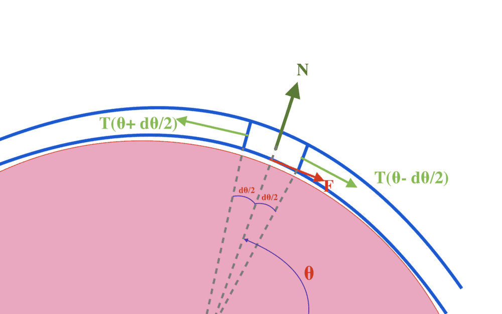

Now consider a small element at an angle ##\theta## to the ##x##-axis.
Balance the forces acting on the element tangential to the surface:$$T \left(\theta + \frac{d\theta}{2} \right) \cos{ \frac{d\theta}{2}} - T \left(\theta - \frac{d\theta}{2} \right) \cos{\frac{d\theta}{2}} - \mu N(\theta) = 0$$Balance the forces on the element normal to the surface:$$N(\theta) - T \left(\theta + \frac{d\theta}{2} \right) \sin{\frac{d\theta}{2}} - T \left(\theta - \frac{d\theta}{2} \right) \sin{\frac{d\theta}{2}} = 0$$You can simplify this by writing ##\cos{\frac{d\theta}{2}} \sim 1 - \frac{d\theta^2}{2}## and ##\sin{\frac{d\theta}{2}} \sim \frac{d\theta}{2}##, and further by noticing that
$$T \left(\theta + \epsilon \right) = T(\theta) + T'(\theta) \epsilon + \mathcal{O}(\epsilon^2)$$If you write out those expansions then you'll obtain that, to first order in ##d\theta##,$$T'(\theta) d\theta = \mu N(\theta) \ \ \ (1)$$and$$N(\theta) = T(\theta) d\theta \ \ \ (2)$$don't be put off by the fact that what I called ##N(\theta)## is actually differential form! You can just combine to get the differential equation$$T'(\theta) = \mu T(\theta)$$and you may be aware that this has a solution ##T(\theta) = T(0)e^{\mu \theta}##; i.e. in the limiting case, the tension increases exponentially around the pulley. [Although the string is not in contact with the pulley at ##\theta = 0##, you can just view ##T(0)## as some constant fixing the solution].
We're not there yet, though, because we want to ultimately work out the force that the pulley exerts on the string - and then by NIII, the force that the string exerts on the pulley. For example, the ##y##-component of the contact force the pulley exerts on the string may be computed via an integral$$
\begin{align*}
\int_{\alpha}^{\pi - \alpha} dF_y = \int_{\alpha}^{\pi - \alpha}\left[ N(\theta) \sin{\theta} - \mu N(\theta) \cos{\theta} \right] &= \int_{\alpha}^{\pi - \alpha} (\sin{\theta} - \mu \cos{\theta}) T(\theta) d\theta \\ \\
&= T(0) \cos{\alpha} \left[ e^{\mu(\pi - \alpha)} + e^{\mu \alpha} \right]
\end{align*}$$But ##T(0)e^{\mu(\pi - \alpha)} = T(\pi - \alpha)## and ##T(0)e^{\mu \alpha} = T(\alpha)##, so you can see the y-component of force that the pulley exerts on the string is$$F_y = T(\alpha) \cos{\alpha} + T(\pi - \alpha) \cos{\alpha}$$and thus by NIII, the string exerts $$\tilde{F}_y = -T(\alpha) \cos{\alpha} - T(\pi - \alpha) \cos{\alpha}$$on the pulley, or in other words, exactly equivalent to if the pulley were acted upon by two forces ##T(\alpha)## and ##T(\pi - \alpha)## in the direction of the string, even though the tension forces don't actually act on the pulley (they only act on neighbouring bits of string!). You can [and should!] do a similar calculation for the ##x##-direction.
Another, perhaps more intuitive, way to think about it is to consider the string in contact with the pulley as part of the "pulley+string-in-contact-with-pulley system". Then, the force this system due to the string is just that exerted by the external axial tension on the bit of the string in contact with the pulley.
Likes songoku, TSny and Lnewqban
  • #32
TSny said:
Be sure to take into account all of the forces acting on M. Anything in contact with M can exert a force on M. If you consider the pulley as part of M, then note that the string is in contact with M. (I think @Lnewqban hinted at this in post #16.)
Damn! I had that originally then mislaid the scrap of paper. Thanks for picking it up.
Likes songoku and etotheipi
  • #33
I knew you were aware of the string's force on M as evidenced by your replies in similar threads.:smile:
Likes etotheipi
  • #34
Well, it's a well known fact that @haruspex never makes mistakes... :wink:
Likes Delta2 and TSny

  • #36
\begin{align*}
I really appreciate you type all this explanation to me but my brain cell just can't process this knowledge. Reading this so many times for these past 2-3 days and I still can't understand. Maybe I will leave this for now before my already few brain cells get permanent damage. I am sorry, and thank you very much for you effort
Is it correct that the horizontal component of tension acting on M is T sin α so the equation will be:
ΣF = M.a
N sin α + T sin α = M.a
Thanks
  • #37
The same magnitude tension acts on the pulley at two different angles.
What is the horizontal component of each?
What is the net horizontal force?
Likes songoku
  • #38
Net horizontal force of tension on M is T - T cos α ?
So equation for M is:
ΣF = M.a
N sin α + T - T cos α = M.a ?
Thanks
  • #39
ΣF = M.a
Thanks
Yes.
Likes songoku
  • #40
For question (d)
Change in GPE - change in KE = strain energy
mg x0 sin α - 1/2 . m . (2a x0) = 1/2 . k . (x0)2
Then solve for x0
Is that correct?
Thanks
  • #41
songoku said:
For question (d)
Then solve for x0
Is that correct?
Thanks
Change in KE between what two states of motion?
Likes songoku
  • #42
Change in KE of ##m## before it moves and after it moves down the plane as far as ##x_0##
  • #43
And what is its KE at x0?
Likes songoku
  • #44
Ah I used wrong acceleration for ##m##. I have to use ##a_m = \sqrt {(a_x)^2+(a_y)^2}## then use ##v^2 = u^2 + 2a_mx_0 ## to find speed of ##m## at ##x_0## and putting ##u=0##. Am I correct?
  • #45
It compresses a spring. Acceleration will not be constant.
Note how x0 is defined:
"after moving a distance xo towards the wall, M will stop"
Likes songoku
  • #46
Initially the system is at rest so no KE and taking the position where ##m## will stop moving after going down the slope as far as ##x_0## as ground level, ##m## will have initial GPE with height equal to ##x_0 \sin \alpha##
After moving a distance ##x_0##, ##M## and ##m## will stop and the spring will be compressed so at this state there is no KE so the loss in GPE of ##m## will be equal to strain energy stored by the spring.
$$m~g~x_0 \sin \alpha=\frac 1 2 k~(x_0)^2$$
Is this correct?
If yes, I have another question regarding acceleration of oscillation. I learn that the acceleration of simple harmonic motion will be maximum at maximum displacement but in this case it looks like the acceleration is zero when the spring is compressed by ##x_0## so it seems that the acceleration is minimum at maximum displacement of the oscillation. What am I missing?
Thanks
  • #47
songoku said:
Is this correct
Yes.
songoku said:
it looks like the acceleration is zero when the spring is compressed by x0
It will be zero velocity but max acceleration.
Likes songoku
  • #48
So the acceleration of ##m## and ##M## will be maximum at ##x_0##? It means that when while ##M## is moving to the right, its acceleration increases but its velocity decreases? And also the initial acceleration of ##M## is to the right at the instant it start to moves but when the spring has compression, the acceleration of ##M## changes direction to the left?
Thanks
  • #49
Thanks
The equilibrium point (for M) of the system will be somewhere between the initial position and the displacement x0. Until M reaches that point it will accelerate to the right, with decreasing magnitude. At the equilibrium point acceleration will be zero. Thereafter, acceleration is to the left.
Likes songoku
  • #50
For (e), I tried to use conservation of energy again but got stuck
Let:
##d## = distance move by ##M## from initial position to reach equilibrium point
##v_m## = speed of ##m## after moving down the slope as far as ##d##
##v_M## = speed of ##M## after moving a horizontal distance ##d## to the right
Ground level is the position of ##m## after moving down a distance ##d## down the slope
I compare the initial condition where the system is at rest and when ##M## reaches equilibrium point
$$mg~d \sin \alpha = \frac1 2 m (v_m)^2 + \frac 1 2 M (v_M)^2 + \frac 1 2 k d^2$$
##v_m## and ##v_M## will be the maximum speed of the oscillation so ##v_m = v_M = \omega A## where ##A## is the amplitude of oscillation and ##A=x_0-d##
So:
$$mg~d \sin \alpha=\frac 1 2 m (\omega (x_0-d))^2 + \frac 1 2 M (\omega (x_0-d))^2 + \frac 1 2 kd^2$$
How to get rid ##\omega## from the equation? Thanks
