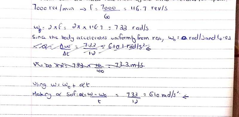

The blade of a circular saw of diameter 20 cm accelerates uniformly from rest to 7000 rev/min in 1.2 s. What is the angular acceleration? How many revolutions will the blade have made
by the time it reaches full speed?
w=2πf
w=w_o +at
I am not understanding the 2nd part of the question where it is asked about how many revolutions will the blade make when it reaches full speed. Please help
Please learn how to post math equations using LaTeX. Your answer above looks like "Gio rad/s^2". There is a LaTeX Guide link below the Edit window to help you out. Thanks.
The angular equations (position, velocity, acceleration) are analogous to their linear counterparts. For linear motion, what mathematical operation do you use (twice) to go from acceleration to distance traveled? :smile:
integration
Let's divide the time during which the acceleration happened into 12 tenths of one second.
How many times the blade completed a full turn within the 0 to 0.1 second?
How many times the blade completed a full turn within the 1.1 to 1.2 second?
