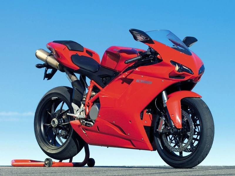

I do not live in the USA, and I do ride, I have a Ducati 1098 currently.
But the theory of it still confuses me, and I can't try many things in this thread because my bike has trail in it's geometry and very expensive parts that need to be replaced in case of an accident [emoji23]
