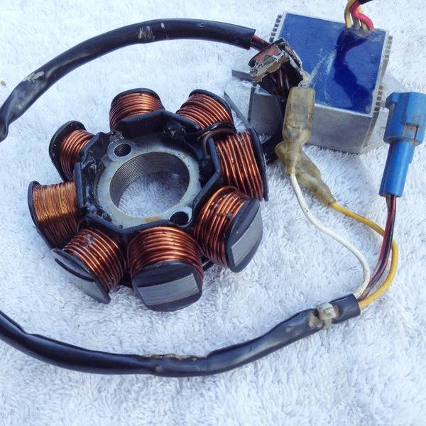

The stock stator looks like this:
Notice it has 8 poles of varying quantities of wire in the coils. One pole appears quite different from it's 7 friends- as I understand it, that s the AC coil. In stock form that coil creates energy to power the cdi box (for spark) and the headlight circuit. That means in the event of a battery failure, the bike will still run enough to ride, but will not charge the battery, eventually resulting in the loss of electric start ability. But will still kickstart and run. The DC side is run through a regulator/Rectifier for DC battery charging and accessories.

The most popular modification is the TrailTech stator and DC modification. This involves replacing the stock stator and adding a new regulator/rectifier, then converting all non-ignition circuits to DC.- It's an easy modification, and here's a snappy of the stator TrailTech sells with it's friend the regulator:
Notice the 8 pole design, larger gauge wires filled further than the stock stator. Again, one pole visually different, which I assume is the AC pole to power the cdi box.
Trailtech makes it easy- almost plug-and-play. Dead reliable, this is the standard modification- done by thousands of riders worldwide.
But it's not enough power, Scotty. TrailTech claims 100 watts, but I suspect it's something shy of that. If I run all three lamps of my bitchin headlight, I'll discharge my battery. I have a digital voltmeter on the bike to monitor such things- voltage drops to around 11.2 to 11.7 at speed, at idle speeds insufficient to even keep the lights on.

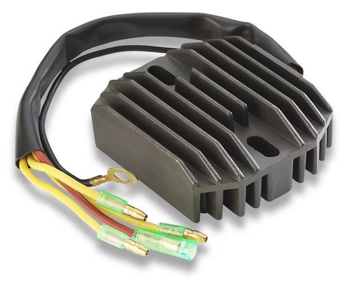

and the regulator/rectifier- clearly far more robust with greater heat-dissipating ability:
I installed this setup on the bike and fired it up. PLENTY of power (Scotty)- this thing must have Dilithium crystals in it. With all demand on the system, it still provides 14.5-14.8 volts at speed, and just over 12v at idle. Perfect, right?

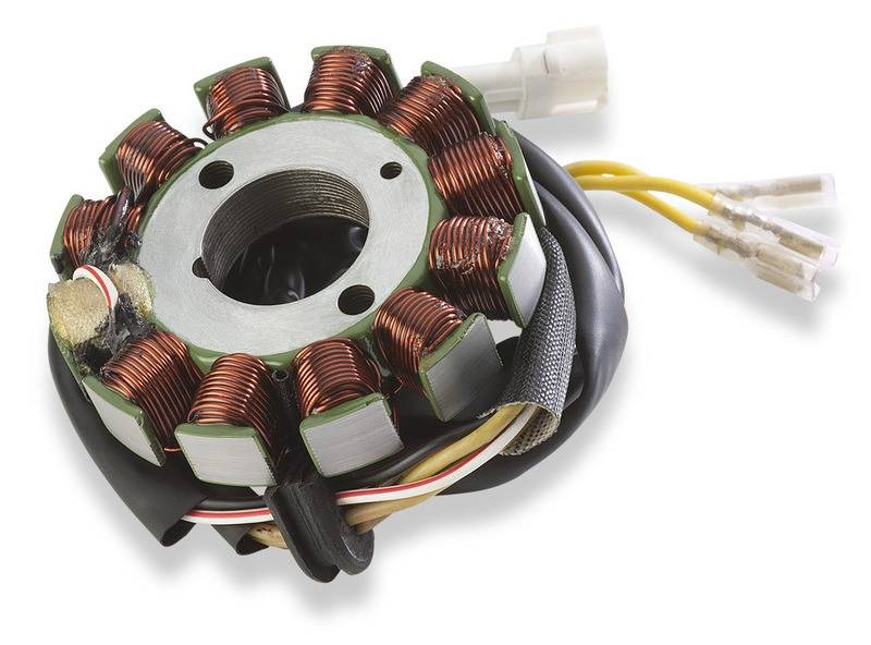

But here's where it gets more interesting, and more internet-based chatter. And, frankly the reason for this winded post.
Notice the 12-pole design? There's another player online who makes highly custom and very expensive 3-phase systems. He eliminates the AC pole completely, and runs the entire system on DC. His claim is that the design of the stator- it's 11 DC poles- is inherently unstable and "unbalanced". He claims a system like this can never be relaible and is based on flawed science.
Do you agree with this analysis? Is the number of poles a factor when creating a reliable power system in three phase?
Further, notice the AC pole is smaller than the previous versions? This stator will start the bike using the electric start MOST of the time. If the battery is at it's peak voltage, and the fuel/air mixture is just right, it fires up like a champ. But if the bike needs to be cranked a bit more, dropping battery voltage, I have to resort to the kickstarter, which will turn the motor faster thus providing more AC power to the cdi box.
Do you believe the AC pole is too small to create enough AC for reliable ignition at lower (estart) rpm?
Could another pole be used to create more AC- use two poles instead of one? And (bonus points) could that be wired in a way to provide redundancy in the case of a (another) single-pole failure?

What you're calling the "AC pole" is the ignition pulser coil. You can test it with an ohm meter (disconnected from the wiring harness). Check you KTM manual for specs.
The unbalanced three-phase does seem unusual. Measure the ohms for each phase (each yellow wire is one phase). Connect the ohm meter between a yellow wire and the ground. (If there isn't a ground wire, use the metal body of the stator). All three phases should be very nearly the same. If one phase is different, then he might have done something in the electronics to compensate. I'll have to check some things about rectifying 3-phase before I can offer anything useful.

The nomimal resistance for a acceptable stator coil is right around 12-15 ohms. The stator that failed checked in at 14, but the bike failed to run until it was replaced.

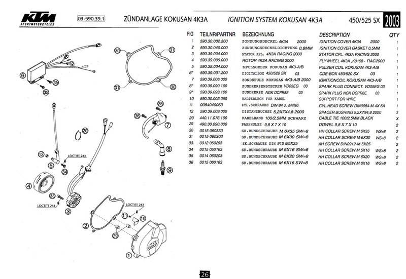

I used the wrong name. The coil on the stator portion is the exciter or trigger coil. It's not timing the ignition, but it is part of the CDI circuit.
Regarding the starting issue, the power output of the stator isn't the issue, it's the trigger coil. You said it's physically smaller than the original version. If the new trigger coil design is supplying lower than OEM voltage to the CDI, then you'll have starting problems.
Replacing the stator unit also gives you a new trigger coil, which likely why your starting problem went away.
As for unbalanced three-phase... ugh. Almost everything I found is related to unbalanced loads. There is some data on three-phase rectifiers being damaged by unbalanced phase angles, which may have some relation to your unit's failure, but I can't say with any authority.

Here's a diagram, if that will help:
I "get" that the physical size of the newer stator's coil (ignition/trigger/exciter) would suggest an insufficiency of power at low RPM- granted we don't know how much the CDI box really needs, we just know the older stator provided more.

the "ac " pole is dedicated to charging the capacitors for your CDI. it has more turns of smaller wire (probably makes a few hundred volts)
and the others to making DC for the accessories
an even # of poles is common but i see no reason why eleven wouldn't do. after all , lawnmowers get by with one pole and you can't get more unbalanced than that...
the regulator works by shorting out the individual phases at point in the cycle to make average voltage at battery what it wants, ~14.3 or so

I notice there's no CDI module connection to battery on that wiring diagram so energy all must come from that CDI winding.

The designer/builder of these units is (at least theoretically) interested in producing a product that works. I'm interested in HIM producing a product that works.
He's currently working on a newer version for which I'll Guinea Pig, but the whole question has me (for some reason) intrigued.
The flywheel is a fixed asset- either KTM or one of the aftermarket that CLAIM higher-energy magnets, but yielded little, if any, difference for me in practical terms.
I suspect it's easier to redesign the stator poles than the flywheel.
hmmm just musing now
since pulsar is in a fixed location wrt TDC
that CDI box makes a decision about spark advance/retard based on flywheel speed, and probably throttle position too
and its thought process is a complete unknown at this point
i would just have to make myself an experimenter's bracket for pulsar coil
and see if changing its location by ten degrees or so affected start
and if so, discuss that with CDI circuit designer guy
lastly - is the orientation of CDI pole wrt TDC imnportant? does that stator mount in two different positions? I noted symmetrical bolt holes in your excellent photos...
CDI Circuit design guy? Probably in Austria or Japan...
The bracket on the pulsar coil gets that pickup VERY close to the flywheel. 10 degrees would make it a lathe.
Correct, the breathtaking photographs show the symmetrical mounting holes on the stator body, so it MIGHT be possible to mount the stator 180° from it's standard mounting position- but...
The cables that exit the back side of the stator fit into a groove machined into the stator cover casting, then clamped in position with a little bracket and a screw.
About the photos- after 30 years in the business, I'd sure the hell better make nice ones.
