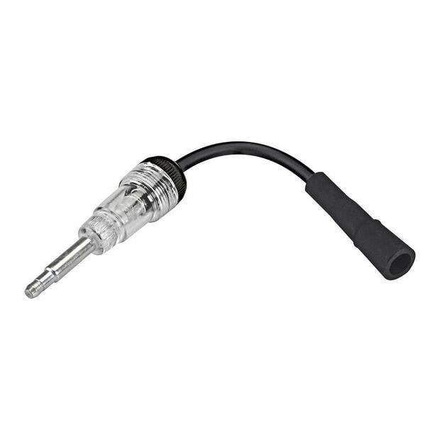

I believe that truck does not have any safety switch killing the ignition based on the position of the gear shifter on the steering column, but just in case, you could easily test how alive one of the eight spark plugs is while cranking.
https://www.harborfreight.com/in-li...SW86CCqe_Urin2Vq0TM2mobs_paa2EQxoCtNAQAvD_BwE
Neutral safety switch will prevent the starter from cranking. No sense to allow cranking while disabling the ignition. Some unsuspecting person would run the battery down attempting to start if that were the case.
