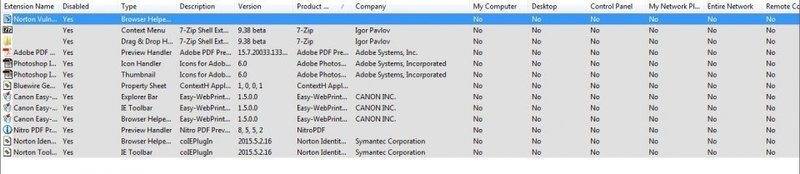

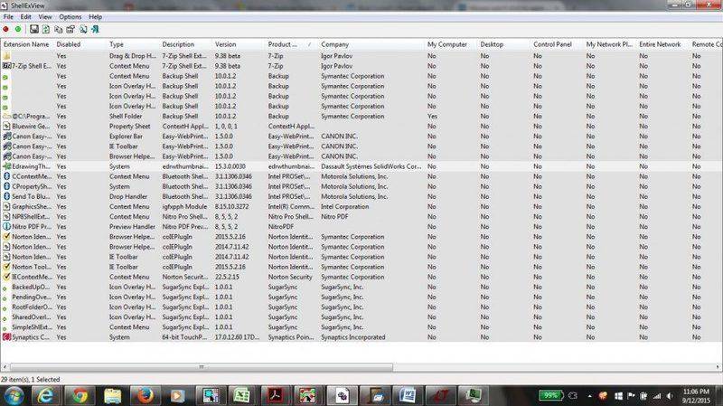

I'm only mentioning this because you seem to have exhausted all of the other options. Have you tried looking at which Services are running on your machine and compare them with the other computer that is working OK? I review my running services from time to time and aggressively turn off services. This has led to occasional problems for me where I will get odd behavior while trying to access directory services. For example, whenever I use Firefox to save a file and try to create a new folder using the dialog, Firefox crashes and closes. I am pretty sure this is due to a service that I shut down but I haven't gotten around to figuring it out. I understand that you may not have shut down a service but it could have been done through an update or a program installation. Definitely use great care with modifying your services - you can really make a mess of your machine.
  • #58
Chronos said:
Having nothing happen when you click on a folder gives me cause to suspect a driver or hardware problem. Try another mouse and see how it works [or doesnt]. I agree and doubt Norton is relevant to the issue. If its a wireless mouse a new battery might be in order.
meBigGuy said:
Yet the browser works fine (the mouse works fine in the browser). What leads you to this weird mouse conclusion? Explain how a mouse driver can cause an explorer window to hang? The mouse works great. The file open hangs. Do you understand that?
A suggestion early on in this thread was that the file associations were broken. In Win7 (which is what I'm running), these can be checked by opening Control Panel, and then clicking Default Programs. Click Associate a file type or protocol with a program to see a list of all file types and the action that is associated with each. If there is some file type (such as .exe, .txt, .jpg, etc.) that has no action listed with it, clicking on a file of that type won't cause anything to happen.

I just loaded shellexview and ran it. Look at the non microsoft extensions (under options). I disabled SecuROM context and Java Helper just to see what would happen.

I went into msconfig, I disabled Dolby Profile Selector, Back Monitor Application, Synaptics Pointing Device driver, Adobe Systems, Inc. Adobe Gamma Loader, Microsoft Office OneNote.
I restarted and the computer still works.
What is Nirsoft? I read a little about the shell. Am I suppose to download and run it?

Regarding Nirsoft. They have two utilities that might tell us something useful.
Shellexview let's you look at Explorer shell extensions and, as an experiment, disable ones that you might not need.
When you run this, click OPTIONS->ignore microsoft extentions, and look at what is left
what_is_hang might tell you exactly is hanging. <--- more interesting
When Explorer hangs, hopefully you can run "what_is_hang" and get a report of where it is hanging.
This could be anything, even your video drivers. It's really hard to tell. So what_is_hang might give us a clue.
