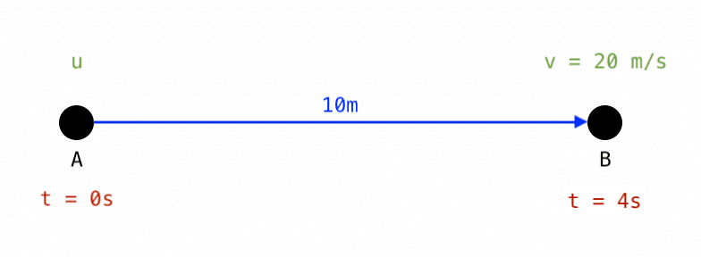

Hi All,
I am trying to solve what I think should be a simple problem, but I must be missing something because I am struggle to solve it. The situation is shown below:
So to summarise:
  • A body starts at Point A
  • It moves in a straight line to Point B, covering a distance of 10m
  • The time taken to travel this distance is 4 seconds
  • When it reaches Point B, it has a velocity of 20 m/s
I need to write a computer program to animate this motion, but I am stuck. How do I find the rate of acceleration? The acceleration could be linear or non-linear, and I do not know what the initial velocity (u) is. Ideally I want it to be 0.
So effectively, I am trying to create this motion by imposing the values listed above, because I need the object to follow this very specific profile of motion.
When I try the SUVAT equations, if I use u = 0, I get a linear acceleration of a = 1.25 m/s (a = 2s / t^2). But then when I calculate the velocity at Point B using this value, v = u + at gives me 5 m/s. This is incorrect as I need it to be 20 m/s as shown above. So I am assuming the SUVAT equations do not work in this case? Do I need to use a non-linear method?
Any help would be greatly appreciated! Please explain the steps if possible, rather than advising something broad like drawing a curve and finding the integral. I need some clear steps to follow.

Your problem is that if you assume constant acceleration then you already have enough information to determine everything, including the initial velocity (which is not zero).
If you insist on starting from rest then it will be varying acceleration. That opens up a wealth of possibilities. You could have it undergo two different accelerations (one being zero perhaps, or even negative), or make the rate of change of acceleration constant. That last option might involve solving a cubic.
Likes PeroK
The SUVAT equations does not work because you are assuming u = 0.
Is u = 0 a must? Then you can not use constant acceleration.
Will your simulation take u as an input? We need some more details.

Jack7 said:
v^2 = u^2 + 2as.
malawi_glenn said:
##s = ut + \dfrac{at^2}{2}##
The trouble with both of those is that they involve both unknowns, a and u. Using either will mean you need to use two SUVAT equations and solve as a pair of simultaneous equations.
As I wrote in post #8, the easy way is to find a SUVAT equation with only one unknown. Omitting a, you have ##s=\frac 12(v+u)t##; omitting u, ##s = vt - \dfrac{at^2}{2}##.
Jack7 said:
How can 'u' be negative?
Jack7 said:
the displacement must be at some point between 0 and 10
It is surprising but true. For a constant acceleration solution, the particle has to start going away from the target but accelerate towards it. In that way it gets a good run up and can reach the desired velocity at a relatively low acceleration, and hence avoid arriving too soon.

Jack7 said:
in order to get from A to B in ONLY that direction in accordance with the specified S,T,V, one must use non-linear acceleration from rest (where rest is at A)?
Yes. I mentioned a couple of options in post #2.
A trivial one is to stay still until accelerating at 20m/s2 gets to B at the right time, but that will not look different from the case of accelerating constantly at that rate from the start and arriving too soon.

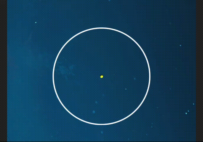

  • #31
Honestly guys I think I've hit a brick wall. I struggle to make sense of the equations above since they are too abstract, it's been too long since I did any proper maths! I have however tried to find a solution based on my understanding (or lack thereof!) of the above recommendations. Here is what I did:
  1. Plot a velocity time graph where u = 0, v = 20, t = 4. The shape of this graph is something I arbitrarily set to an exponential shape, given that this is the profile I am looking for. I think you guys were recommending this above too.
  2. Use step wise integrals to find the area under the graph, in order to create a corresponding displacement time graph. Remember that I said I need displacement as a function of time. (I have a function that can do this accurately for as many intervals as needed).
  3. Now Step 2 doesn't take into account my distance of s = 10m since it only looks at the velocity time graph, so the y-axis of my displacement time graph is not correctly scaled. Therefore I scale it to match my displacement profile of s = 10.
  4. I move the particle using this displacement time graph.
The result of this process is below:
The motion discussed in this thread is the motion from off-screen right up until it hits the circle directly below the yellow point. After that the particle follows a circular motion with an angular velocity matched to the linear velocity. So if it works, we should see a nice smooth transition.
You can see however that it has not worked. I get an acceleration but it is too rapid, which makes the particle suddenly slow down after the linear motion has occurred. I assume that I have made a mistake in Steps 2-3 because I am effectively experimenting here without actually knowing what I am doing. :headbang:
If anyone could please outline where I've gone wrong, I'd really appreciate it.
  • #32
Very hard to tell if you do not show any equations.
So your ultimate goal is for that square to start at a distance 10 m from the lowest point of a circle, accelerate towards it in 4 seconds, hit speed 20 m/s and then it will move along that circle with such tangential speed?
Then yes, an exponential acceleration will make the last second cover 87% of the total distance (3,46 m) and not look any nice.
Does the initial speed has to be zero?
Yes that's absolutely right, that is my goal. (Note that 4 seconds and 20 m/s is one case, the values will change in different cases and the clip shown above uses different values. The key is getting the transition to the tangential speed to be smooth).
Regarding your exponential comment.. shouldn't matter though right? It should still end with the correct velocity shouldn't it? Therefore the transition to tangential speed should still be smooth. The initial speed does not have to be zero per se, but I thought we established earlier in the thread that it had to be.
  • #35
no no it does not have to be 0, it is a contraint you can play around with once you have settled for what velocity profile you want.
