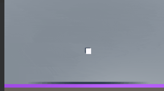

I was running into some weird behavior in a game (Unity/PhysX), and it got me to wondering whether the behavior was reasonably accurate, or whether it was a bug in the physics simulation. The issue related to friction, in a potentially unrealistic case where Static and Dynamic friction are equal. I realize PhysX isn't an accurate simulation, but in this case, I was curious about whether it's doing the right thing, or if this is incorrect.
First, the "weird" thing I'm seeing. My setup is a world where in addition to gravity applying -Y force, there is also a constant -Z force ("Wind") pushing a box into a wall. The wall is frictionless, but the ground is not. The box ("player") can move in four directions by applying force. Here's a top-down view of this world:
If the "Wind" force is equal to the "Player's" movement force, then walking into the wind results in no movement at all, and the player remains held against the wall. If the "Wind" force is significantly less than the player's movement force, the player can overcome the Wind, and walk forward. But if the Player's movement force is just slightly higher than the Wind force, odd things happen. Let's say the Movement force is 105, and the Wind for is 100. In that case, the player won't actually move if they try to move into the wind. My assumption is that the small amount of additional force the player can exert compared to the wind is not enough to overcome the frictional force.
But here's the weird part. If I start by making the player slide left/right, and only then do I try to move into the wind, I can make some forward progress. The image above shows this in action. I'm always applying the same forward force when trying to move forward. But while moving left/right, I move forward more easily than trying to move forward from a dead stop. This would make sense to me if Static and Dynamic friction were different, but in this case I have them set to be identical.
The specific behavior is that while the player is moving even a little but left/right, he can move forward. As soon as he stops sliding left/right, he is no longer able to make any more forward progress.
I was trying to reason through why this might be reasonable. My thought was that friction can only exert so much total force, and so by moving left/right, it somehow lowers the amount of frictional force that can be applied against my forward movement. Does that make sense? Or is this simulation behavior just wrong?

The video makes complete sense. The major difference (as I see it) between the video and the case I'm describing is the additional of the extra dimension. It makes sense to me that if I'm heading into a strong headwind, I could make some initial progress if I started with some momentum in the direction of the wind. But it doesn't make sense to me that moving perpendicular to the direction of the wind would help me at all in trying to make forward progress into the direction of the wind. That, however, appears to be happening in my simulation.
So reframing the question, assuming Static and Kinetic friction are equal (or very close), would inertia perpendicular to the direction of the wind help me at all in making progress into the wind? I assume the answer is no, and that this simulation result is inaccurate. But that's what I'd like to understand better.
Putting it another way, let's image a concrete block sitting on the ground. It's pretty difficult to move, and I can't move it at all if I push it North; the friction is just too great. Now let's say someone comes by and gives the block a strong push to the East, and the block starts sliding. I run along side it, matching its speed, and I try pushing the block North again while it's in motion. Assuming Static Friction equals Kinetic in this case, could I now possibly be able to get the block moving North? Or would the frictional force resisting northward motion be the same as it was before?
The object can only generate so much frictional force. It kind of seems like it has a friction budget. If the object is moving quickly East, a lot of its friction budget is "used up" resisting its Eastward motion. Does that effectively leave less force to resist its Northward motion? If I really launch the object East, so it's going thousands of meters per second (and it somehow stays nicely on the ground the whole time), does it generate the same amount of Northward friction when I push it as it does when the object is moving only very slowly Eastward?

There are two different factors here:
1) The propulsive force can be used to gain sideways momentum while the forces along Z from the wind and wall cancel. That stored momentum can be used to go along positive Z against a bit, while slowing down. Keep in mind: The net force determines acceleration not velocity.
2) While moving sideways, the friction has no Z component, so the net Z force can become positive and you can accelerate along Z for a while, until the friction's Z component becomes too large. This is why it requires less pull force to pull out a plug, when also turning it.

Infinitesimal in both cases. You need to ask something more like "how much sideways force to maintain 0.1 m/s sideways motion at that downhill speed"?
Or "how much sideways force to maintain a 1 degree cross-slope deflection at that downhill speed"?
Both questions can be answered if you draw a free body diagram, identify the frictional force and split it into down-slope and cross-slope components.

Friction is complex and can modeled in different ways. But in the simple Coulomb model this is the case, because the direction of friction is velocity dependent, but its magnitude isn't.
Since you have the simulation, why don't you just visualize all the force vectors or output and plot them, to see what is going on.
Thanks for all the help on this. I believe I understand the behavior now mathematically, and it's starting to sink in intuitively as well. I think the behavior I initially showed is reasonably accurate, and represents how friction actually works. It still "feels" a bit odd, but I think I can get past it. Thanks again for the help.
