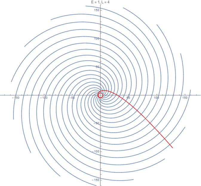

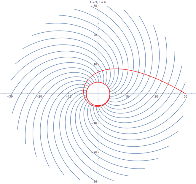

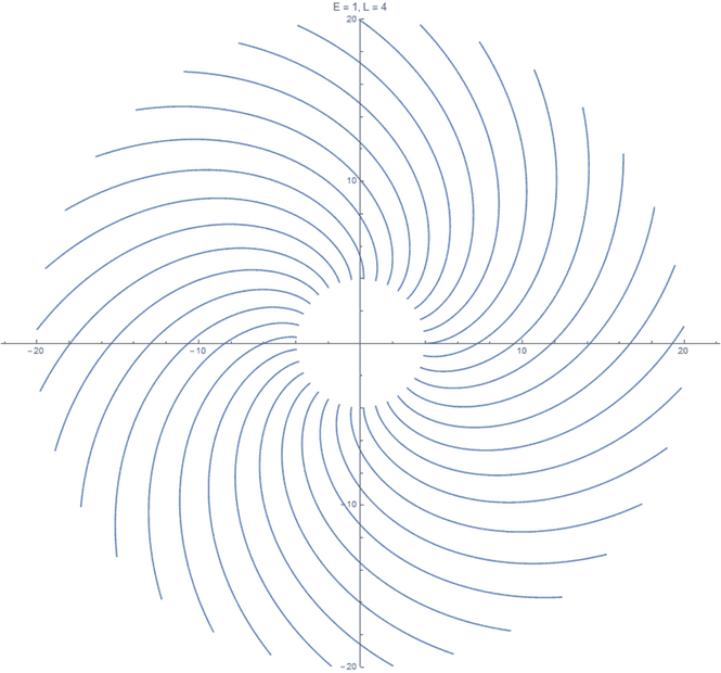

For the case ##\tilde E = 1## and ##\tilde L = 4M##, I obtained the following ##r## - ##\theta## plots for the "surfaces" of constant dynamic phase ##S## (according to equation (27), box 25.4).
The axes are scaled to represent values of ##r/M##. From this plot, you can get an idea of the shapes of particle trajectories corresponding to the given values of ##\tilde E## and ##\tilde L##. The trajectories intersect the lines of constant ##S## at right angles. To test this, I numerically solved equation (25.41) to generate a particular trajectory and added it to the plot above:
The trajectory spirals asymptotically to ##r = 4M## [edited]. Your trajectory also spirals, but your trajectory is more circular for large values of r. My graphs above only go out to ##r = 30 M##. Here's a graph that includes greater values of ##r##.
Page 662 of MTW describes different trajectories for different values of ##\tilde L## and ##\tilde E##. If I understand it, ##\tilde E = 1## corresponds to a particle falling in from ##r = \infty## with zero initial speed.

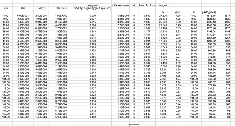

I've had my think and run my model for a value of r/2M = 163 and found that my curve spirals 5+ times before it reaches r/2M = 4. I've attached a screenshot of my initial data. I assume that the result of the integral is an angle given in radians. I think that the spiralling arises because even at ##r = \infty## the particle has a velocity perpendicular to the radius, giving it the angular momentum ##\tilde L##.
I'm going to produce an additional curve for a slightly increased value of ##\tilde E## to see if I can replicate the trick used on page 643 works and produces a trajectory.
The only thing I see that might be an error in your table is that the integrand should have an overall factor of 1/L = 1/4. This comes from solving equation (27), page 649, for ##\theta## when ##t = 0## and ##S = 0##. This will slow down the rotation of your curve.
The case ##L = 4##, ##E = 1## is special. The integral in (27) can be done in closed form to get ##\theta = \sqrt{r/(2M)} + \tanh^{-1}(\sqrt{2M/r}) + {\rm const}## . The constant doesn't matter, we can let it equal zero. Or, you could choose the constant so that this formula agrees with your data for ##\varphi## when ##r/M = 4##.

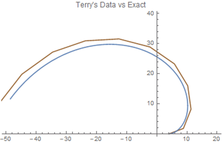

I believe you are getting the correct shape now. I took the first 11 points from your data table in post #8. I divided your angles by 4 to account for the missing overall factor of 1/L in the integrand in your table (mentioned in post #9). Here's what I get for a comparison between your data and the exact graph:
The brown curve is your data and the blue is ##\theta = \sqrt{r/(2M)} + \tanh^{-1}(\sqrt{2M/r}) + {\rm const}##. I did flip your data over (mirror image) and rotated the graphs to have ##\theta = 0## at r/M = 4. They match well considering the step size of your numerical integration.

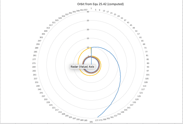

I've abandoned the attempt to get a path using the 'interference' method. There is a problem creating curves for values of ##\tilde E < 0## because the particle ends up at distances r/M >4, they don't have the energy to scale the full height of the potential, so the interesting part of the curve can't emerge. As an alternative, I adapted my spreadsheet to perform the integral of Eq 25.41 and have produced a curve similar to yours. See attachment. I'm currently exploring ways of actually performing the integration analytically (I now have φ as a function of u but I haven't yet worked out how to turn ##\phi (u)## into ## \phi (r/M)##)
Hi TSny

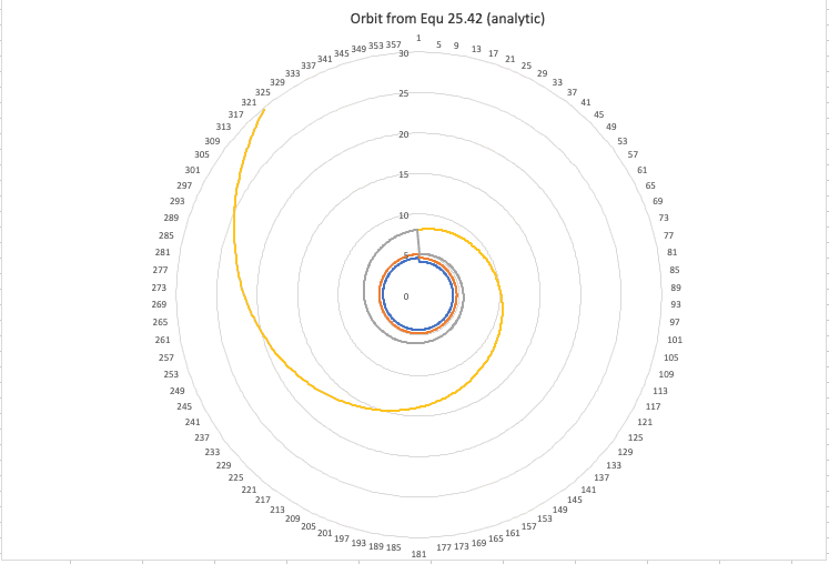

I think I've cracked it now. Equation 25.42, for the special values of ##\tilde E= 1##, ##L \dagger = 4##, has the 'analytic' solution:
##\phi = -4 \sqrt 8 ln(tan(\frac{1}{2}arcos(2 \sqrt(\frac{M}{r}))))##
I've used my spreadsheet to produce the orbits for the computed integral and the orbit for the 'analytic' integral. The two curves are very similar, though the computed solution has more rotations in the inner core. I reckon that this is down to the fact that my computed integral becomes less accurate, with slightly lower values for the integral, as the curve of the integrand gets steeper. At the higher values of r/M, the values for the integral are quite close.
I'm going to do a bit more work to explore the discrepancy between my calculated curve and the 'analytic' curve to see if I can find a satisfactory explanation.
The result for ##\phi## from (25.42) can be expressed in different, but equivalent, ways. I found the following expressions: $$\phi = -\sqrt{8}\tanh^{-1}\left(2\sqrt{\frac{M}{r}}\right)$$ or $$\phi = \sqrt{2}\ln\left( \frac{1-2\sqrt{\frac{M}{r}}}{1+2\sqrt{\frac{M}{r}}}\right).$$These would agree with your expression if your expression didn't have the overall factor of 4. Since ##L^{\dagger} = 4##, I wonder if one of us has dropped or added an extra factor of ##L^{\dagger}##.
I'm fairly confident about the factor 4 in my expression. The results from using this expression for ##\phi## with the factor 4 are very close to my original computed values. Without the factor 4, the discrepancy would be problematic.
I'll see if I can wrangle my expression for ##\phi## into yours.:smile:
Here's how I get my result. Equation (25.42) reads $$\left(\frac{du}{d \phi}\right)^2 = \frac{\tilde{E}^2 - (1-2u)(1+{{L^\dagger}}^2)}{{L^{\dagger}}^2},$$ where ##u = M/r##. [Edit: The last factor in the numerator on the right should be ##(1+{{L^\dagger }}^2u^2)## instead of ##(1+{{L^\dagger}}^2)##.]
Rearranging and letting ##\tilde{E} = 1, L^\dagger = 4##, I get $$d\phi = \pm 2\sqrt{2} \frac{du}{\sqrt{u}(1-4u)}.$$ The ##\pm## just corresponds to clockwise or counterclockwise orbit.
Integrating, $$\phi = \pm \sqrt{2} \ln \left( \frac{1+ 2 \sqrt{u}}{1-2\sqrt{u}}\right) + \rm {const}.$$ This is equivalent to your result in post #14 except for a factor of 4. When taking the square root of both sides of (25.42), did you happen to forget to take the square root of ##{L^{\dagger}}^2## in the denominator of the right side of (25.42)?
