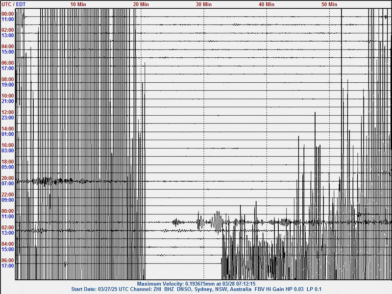

from my seismograph here in Sydney, Australia

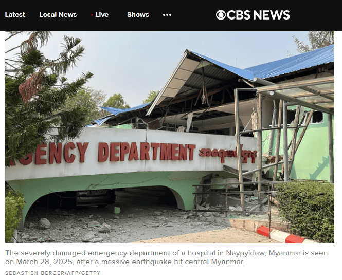

https://finance.yahoo.com/news/myanmar-quake-death-toll-surges-040431144.html
(Bloomberg) — Myanmar said the death toll from Friday’s powerful earthquake has passed 1,000 amid reports of extensive damage in the second-largest city of Mandalay.
Earthquakes are rare in Bangkok, but relatively common in Myanmar. The country sits on the Sagaing Fault, a major north-south fault that separates the India plate and the Sunda plate.
Brian Baptie, a seismologist with the British Geological Survey, said it appears a 200-kilometer (125-mile) section of the fault ruptured for just over a minute, with a slip of up to 5 meters (16.4 feet) in places, causing intense ground shaking in an area where most of the population lives in buildings constructed of timber and unreinforced brick masonry.
https://apnews.com/article/myanmar-bangkok-earthquake-0a2bd512bca189d034905566605989e9
https://apnews.com/article/thailand-earthquake-bangkok-4fce87aced74b1fc0cf260fb5454d353
The 7.7 magnitude quake struck at midday, with an epicenter near Mandalay, Myanmar ’s second-largest city. Aftershocks followed, one of them measuring a strong 6.4 magnitude.
