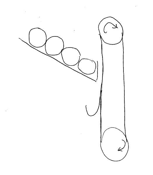

There are challenges to using a pneumatic conveyor. You would need a blower capable of over 6 in w.c. static pressure at an appropriate flow rate. Such a blower will be noisy. By the time a beer can bounces around a couple of bends in the pipe, then is shot out into a receiver, it will be well shaken.
A different approach that allows automatic single can feeding, and does not shake up the cans is a vertical (or approximately vertical) conveyor as sketched below:
The cans are in an inclined rack. A belt conveyor with hooks attached picks up a single can and delivers it without bouncing or shaking. A pair of hooks pass through slots in the inclined rack. A zig-zag rack could hold several cases of cans. The bottom pulley would be inside the refrigerator. The hole in the top of the refrigerator would have rubber flaps to seal against air leakage while allowing cans and hooks to pass through.
McMaster-Carr has conveyor belts in any width and length: https://www.mcmaster.com/conveyor-belts/made-to-order-conveyor-belts-6/. You can buy conveyor belt pulleys (expensive) or make them yourself out of wood. A low speed, low load conveyor such as this does not need precision steel pulleys.

thank you for your reply.
Right now I’m leaning towards a gravity fed rack, with and actuator that lines up with the bottom can. When the call for beer is initiated , actuator pushed bottom can into tube. Can is seated inside tube , suction starts and pull can up and through.
The gravity rack will position can on its side , and the tube inlet will be coming in the side of the fridge. It will make one bend , and continue straight up to the man cave.

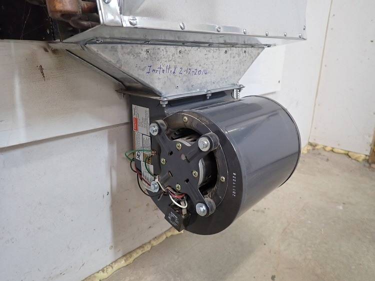

For this application , is something with the suction I need feasible ?
Yes. It will need to be something with about the suck of a shop vacuum. A bathroom exhaust fan or centrifugal blower similar to the photo below will not move the cans.
Use a shop vac that comes with a 2" hose. The smaller vacs might not move enough air.
