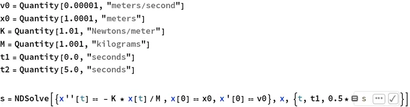

Edit: Tried adding units to the start and stop time as well...
Code:
v0 = Quantity[0.00001, "meters/second"]
x0 = Quantity[1.0001, "meters"]
K = Quantity[1.01, "Newtons/meter"]
M = Quantity[1.001, "kilograms"]
t1 = Quantity[0.0, "seconds"]
t2 = Quantity[5.0, "seconds"]
s = NDSolve[{x''[t] == - K * x[t]/M , x[0] == x0, x'[0] == v0},
  x, {t, t1, t2}]
And now it's saying...

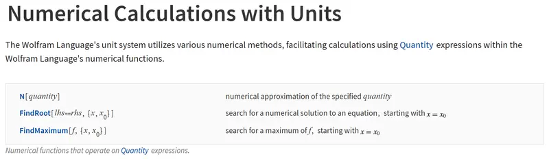

Code:
NDSolve::ndnl: Endpoint 0.s in {t,0.s,5.s} is not a real number.
