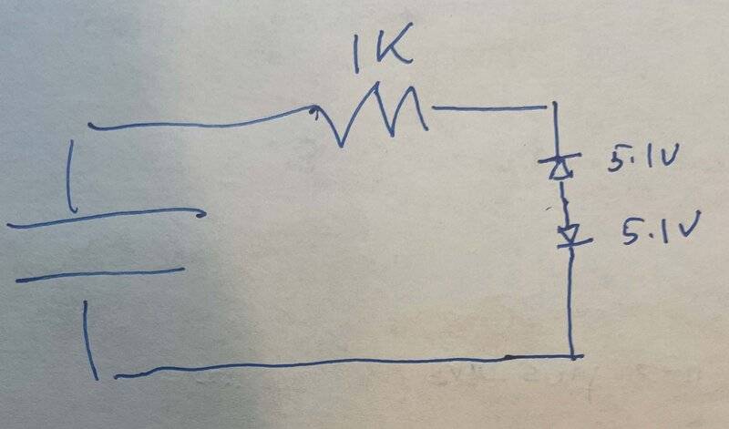

Use series limiting resistors and diode clamps to reduce the max voltage seen by the comparators.
Likes DaveE
I'll give that a try. It's simple enough.

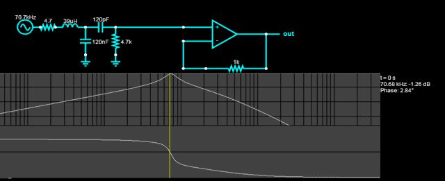

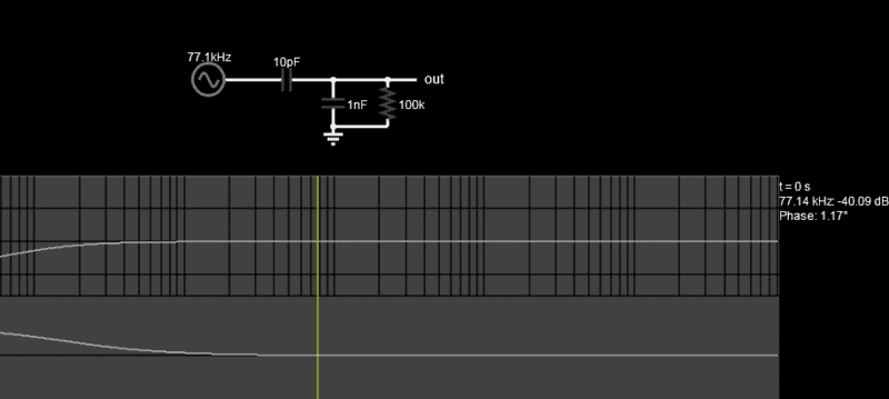

Falstad.com/circuit is more of a conceptual training device I use to show others, then I'll add parasitics to show reality. But LTspice does nice plots too.

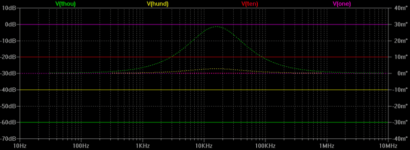

It took me a few minutes to realize your mid-band peaking in phase error was due to truncation of 1.11k vs 1.11111K although 0.03 deg is maybe flat enough. 1% real tolerances would be 10x worse.

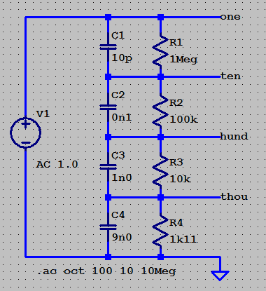

For a real 9n0 capacitor, I would use a couple of real 1n8 caps in series.
For the 1k11111 resistor, I used 1k2 // 15k, but then the phase error in the simulation become femto-degrees and the phase plot was a mess due to floating point resolution. Hence, I simulated 1k11 to show the crossover between R and C at f=1/(2Π⋅RC).
Likes TonyStewart
In theory, that works perfectly. In practice, tolerance errors arise.

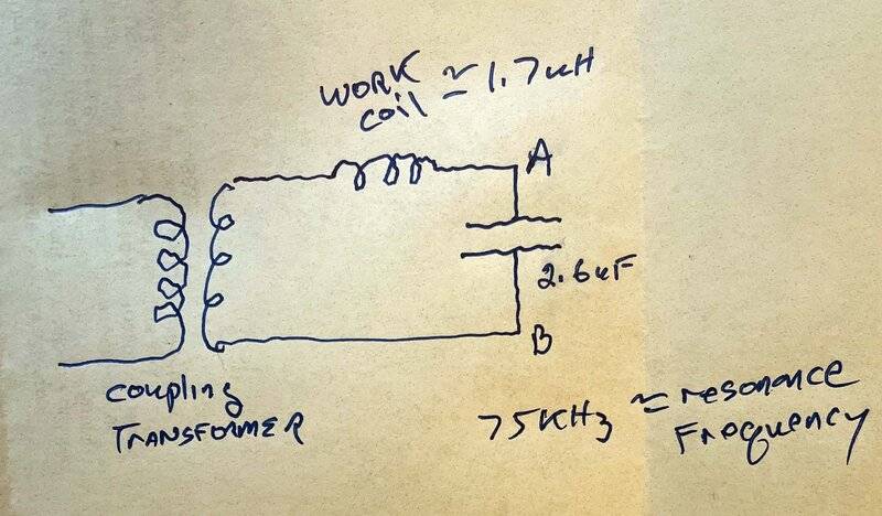

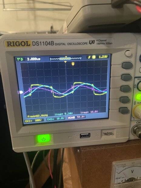

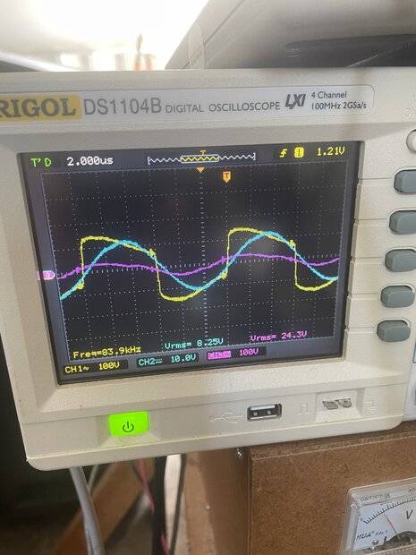

Thanks for the help so far, but I'm still not making progress.
The first image is the basic schematic of the induction heater tank using a coupling transformer to drive it. The capacitor is 2.6uF and resonance is around 75kHz. The second image shows the inverter voltage (yellow) and current (blue) both in phase. At this point the tank capacitor voltage lags the current by 90 degrees (still shown in the second image). I am using a differential probe on the tank capacitor. This voltage can range from 0 to 400Vrms.
I need to measure this voltage without affecting its phase, scaling it down to under 15v at its maximum value. I tried using 10k 5W resistors connected to points A and B with two zener diodes (1N5338, 5.1v 5W) back to back to limit the voltage to +/- 5v. I got the waveform shown in 3. As you can see, the waveform is severely shifted to the left. The zener setup is shown in image 4. I am keeping the voltage low because I know the resistor is undersized for the full wattage.
I am guessing that the high resistive reactance overwhelm the capacitative reactance, so the phase angle is close to zero? I tested the resistor/zener circuit using a signal generator at 70kHz and it works there. It does not work when I connect it across the actual tank capacitor.
Anyway, my question is how can I measure the tank capacitor voltage, scaling it down, without affecting the phase angle. Again, my goal is determine the zero crossing.

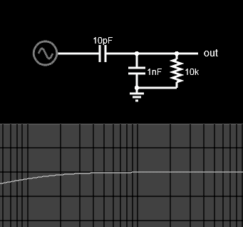

Schematic omissions account for your errors.
The LC phase shift is 0 to 180 deg so is should be 90 deg at resonance with Vcap as output.
If 10K is loading your signal, then your source and transformer impedance ought to be defined along with turns ratio.
In any case, one solution is to use a large 1nF metal film (1kV) to small 100 nF ceramic (>50V) for a 100:1 reduction and no loading effect. Then the diodes are not necessary.

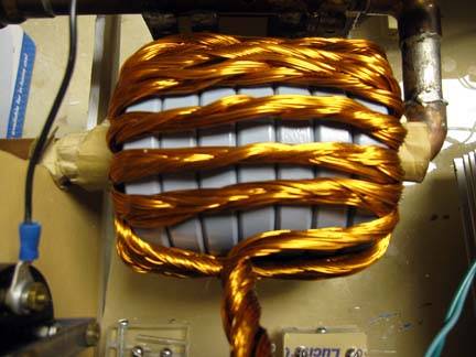

The coupling transformer is 20 turns around a toroid core. A single turn copper tube goes through the center.
Are you suggesting using a capacitative divider 1nF:100nF? I've tried one but not with those values. I'll give it a try.

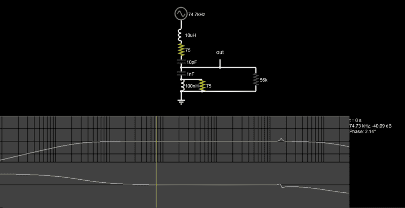

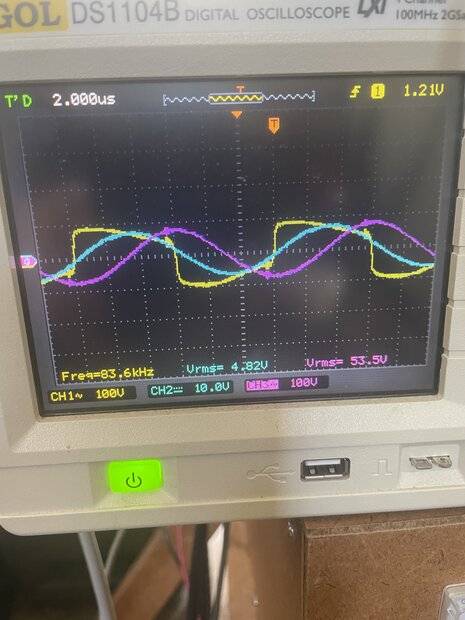

So I tried the capacitor values. On a tabletop waveform generator it reduces the input by a factor of 100 as predicted. However, on the tank circuit it only reduces the capacitor voltage by a factor of 3 and the phase is shifted to the left. I would think this should work, but it does not.
Where is the ground on the secondary circuit, is it terminal B of the capacitor?

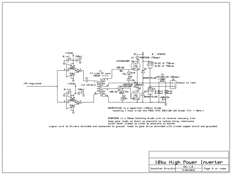

The 15v supply uses the regular MAINS as a power source. The 240vac for the inverter voltage rails goes through an isolation transformer so there is no connection to ground. The LC tank that is driven by the inverter is coupled with a toroid transformer, so it too has no path to ground.
I've been working with high voltage for over 20 years. This is just a hobby for me.

The image is the coupling transformer.

I made a solid ground connection and much as I thought there is no difference. The probes work fine and as you can see if a previous post image, they accurately show the 90 voltage lag on the capacitor when I put the probes across it. I get the same strange behavior with a ground connection and a resistor or capacitor divider:
I do not get 1:100 attenuation; I only get about 1:3
The signal is shifted to the left and distorted.
If anything comes of this I was playing with the LTSpice last night and I thank you for the link. When setting up the .trans command it seems that the Mac requires you to manually type in the values while the PC has a better interface. Is that correct?
Also, what is the deal with the currents going backwards unless I flip the components. It seems current flows from node 1-->2, 3-->4. The voltage source also seems to have the current going backwards from + to -.

  • #36
Made a solid ground. Connected the divider. No difference and still wrong measurements. Then, as a guess I disconnected the p5205 differential probe and held it in the air. I was seeing the strange waveform.
Apparently, my probe has issues and I was never making a proper measurement. I switched probes and now I can see the proper phase shift. I'm still not seeing a 1:100 division, but it is better. I'm going to buy another probe.

The Diff. Probe P2505 only has a CMRR of > 300 @ 100 kHz. or <-30dB error. So a good ground is essential on the signal with a short ground connection. Verify again with both inputs and gnd to gnd for a flat trace.
Probing the HV output will radiate EMI measurement problems beyond the scope of this thread. only use the C divider output.
You can improve it further with 100 pF\10 nF ( Z(f)= 212 Ohms @ 75kHz to probe.

When I connect both leads together they are picking up significant EMI when I power up my device. I suspect something is not working with the probes. Any suggestions to troubleshoot them or the power supply (1103)?
  • #43
You will have to show a picture of everything with all power sources with schematic showing nodes, and sources of AC. SMPS (DC) are notorious for leakage of CM noise when isolated. Then we can analyze and fix.
  • #44
I can get there tomorrow and see what I can do. However, I just connected both probe ends to a ground wire and I do not get a flat line. When I power on a high frequency device nearby I see a high voltage signal on the scope. Not sure what else there is to show. Seems like something is broken.
  • #45
After switching to a standard probe I was able to get the correct values and waveforms using a resistor divider as well as a capacitor divider. Both worked as predicted.
The problem was with the differential probe and the noise overwhelming the signal. I am done with this thread and will try to address the probe issues in my other thread.
Likes TonyStewart

Edited LTspice schematic and plot files attached.
Includes notes on simulation, and a 101:1 voltage divider.
  • #47

6. How is the behavior of the voltage divider with the parallel capacitors different/better than just one or the other.
The resistors maintain the DC which is important for a zero crossing detector or an oscilloscope. The capacitors give it the wide bandwidth required to avoid phase shifting fast signals. The parallel combination keeps the phase shift zero, and the frequency response flat, all the way from DC to daylight.
