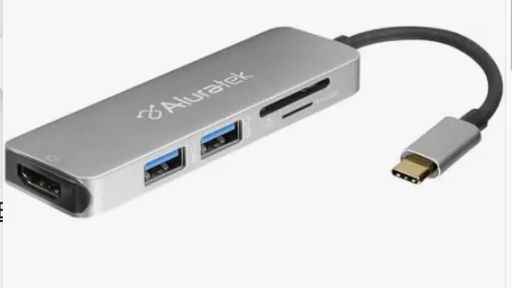

I have a DELL monitor that I plug in to my Mac with an HDMI-USB-C hub/adapter.
Anytime I so much as breathe on the hub/adapter (such as plug anything else into it) the Dell monitor goes black.
But only for 5 seconds or so, so not like your problems. It does seem weird though, as if it's a bad connection.
