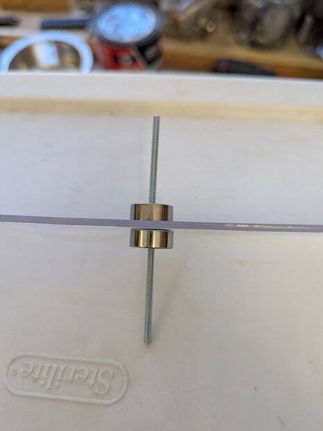

There is no facility here to upload a photo of the "sandwich"
Yes there is. Just use the "Attach files" link below the Edit window.
I don't see the Attach files link. Could it be because this is my first post? (Other forums don't allow posting until some credentials are earned.)

The chess layout is composed of 40 mm squares, the "men" are 18mm (custom made on 3D printer) so they slide in between other players. The software also allows for "en-passant" and castle-ing. A collaborator in Argentina worked on the software, my weak point, but he is also having issues with electromagnets and is waiting for me to make mine.

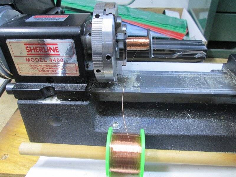

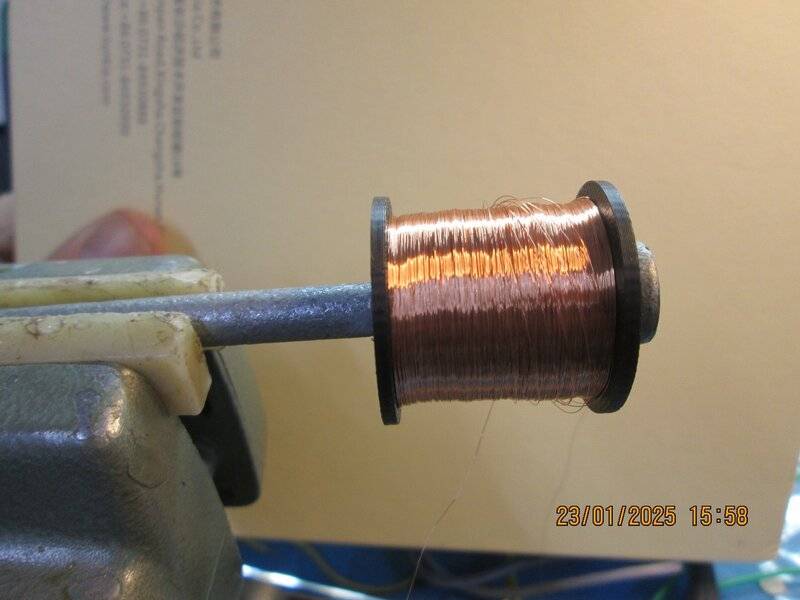

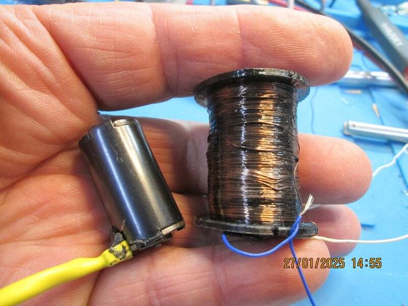

UPDATE Jan23
I made a coil with #38 wire, spun on a bobbin I made on 3D printer, of size that would fit in my Chess game. I calculated 21,200 turns (I used a slow turning lathe to load the bobbin), measured 1600 ohms, which worked out to 666 meters of wire. I did not wind wire on metal core (I tried but failed because lathe chuck wouldn't grab the bobbin), using only the plastic open air core. Measured Gauss at 271 @24 volts. current was only 8 mA. Here's the thing: more current or more turns gives more field strength but more turns results in more resistance so less current can be used. I can increase voltage but there is a limit. To obtain the max current of 130mA in a 1600 coil would require a power supply of 208 volts. So I could get larger wire, #34 perhaps. It has less resistance but is thicker so I'll have fewer turns! I'm also going to wind more #38 onto a metal rod instead of having a rod in a plastic sleeve as I did. Left photo is my coil on a rod, under test.

With a number of turns of 21200 and a current of 0.008 A, the magnetomotive force is 170 ampere turns. The magnetic induction generated by this force depends on the core material and the average length of the magnetic line. A magnetic line is a line along which a magnetic field closes. If you insert a long core into the coil as shown in the photo, the length of the magnetic line is very long, so the magnetic induction is weak. I suggest you cut off the rod according to the height of the coil, that is, make sure that the core is inside the coil and does not protrude beyond its limits. You can increase the magnetic induction in the following way. You can apply the winding in two layers. That is, the first winding of 10600 turns will give a current of 0.016 A, the second winding of 10600 turns will give a current of 0.016 A. These windings are connected in parallel. You will get the same number of turns, but the current will be 0.032 A, that is, 4 times more. In the future, you can recalculate these two windings by one winding of a wire with a larger cross-section. This is the second option. First, I would suggest that you make a proper low carbon steel core and check the result.
If your electromagnet is too strong during the test, you can reduce the number of turns, and the current can be limited, for example, by using a resistor connected in series or using a transistor.
Wow! Good advice. Actually the nail in the photo was only used to hold the coil up and it was my intention to replace it with a piece that fit the dimensions of the bobbin. Today I'm winding another coil directly onto the metal rod. Good idea about the parallel coils. I will try that too. I assume the coils would be applied in the same direction?
