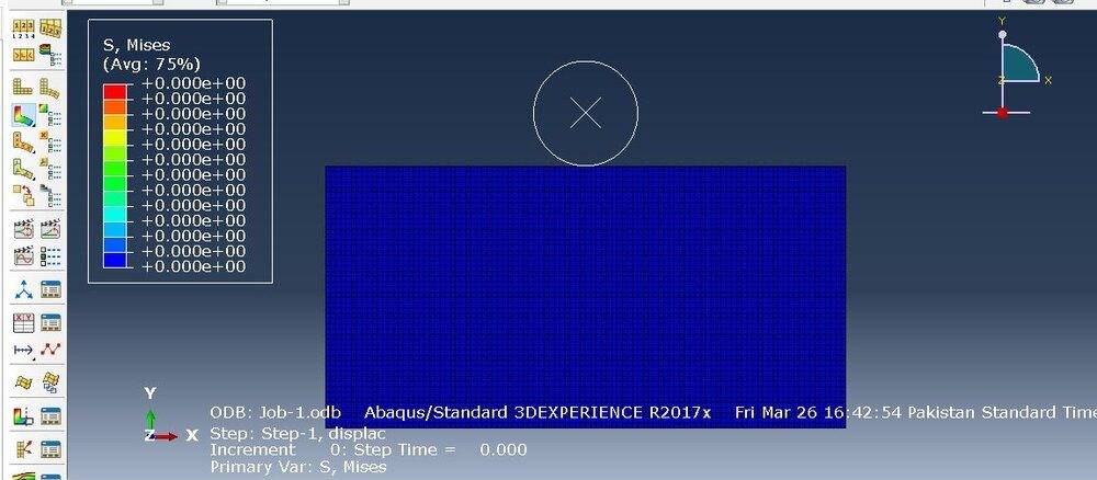

Need assistance in Abaqus. Doing static analysis....
I'm doing static analysis. I have already set up all the prerequisites, preprocessors such as material addition, sectioning, defining boundary conditions, and displacement. However, I'm not getting the results. Please suggest anything.
Kindly find the attachment.

The last time I used Abaqus, it came with a thick book of example problems. Run some of those. Then modify an example problem. Then set up the simplest analysis that you can think of. Give particular attention to the first lines in each problem where you tell the software how to get started.
When all of those are working, you should be ready to run your actual analysis.
That’s zero increment (step time = 0). No wonder there are no results, scroll to the end of the step using arrow buttons on the top right.
