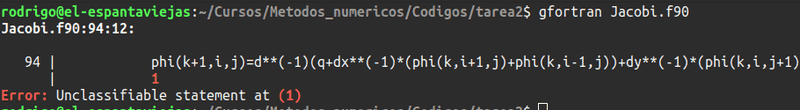

I have a problem with this code that i made. every time that i run it, this shows an error (is the same in the image), and i don't know how to fix this. It's a jacobi relaxation method for a dirichlet boundary conditions.

Nikolas_Ex_Aguirre said:
Fortran:
phi(k+1,i,j)=d**(-1)(q+dx**(-1)*(phi(k,i+1,j)+phi(k,i-1,j))+dy**(-1)*(phi(k,i,j+1)& +phi(k,i,j-1)))
The error message says there is a problem with line 94, which I've copied above. It looks to me like you are missing '*" to the right of the assignment operator, and between d**(-1) and the stuff following it. In other words,
phi(k+1, i, j) = d**(-1) * (a + dx**(-1) * ...
There might be other errors as well.
Do yourself and anyone else who has to read your code by inserting some spaces. If this makes the line too long, break up the line into multiple assignment statements.
Likes dlgoff and berkeman
