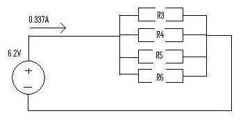

In this instance we are considering the parallel set of R3||R4||R5||R6 by it's lonesome. You could actually look at it as the following drawing (attached).
Zryn said:
Getting closer!

Nope, current dividers are a little tricky. Reread the following and then look at the equation below to see what's happening:
Where 'Rt' is the total resistance of the resistors which are *not* the resistor in question which you are trying to find the current through, 'Rn' is the resistor in question which you are trying to find the current through and 'I' is the source current.
Ir = Rt / (Rt + Rn) * I
Ir4 = (R3||R5||R6) / (R3||R5||R6 + R4) * I

ok yes - but r3 + r5 + r6 = 220 + r4 (80) = 300?
or am I looking at it wrong?
do you mean the 18.33?
How do you combine resistors in parallel?
R3 + R5 + R6 as a series combination = 220R
R3||R5||R6 as a parallel combination = ... ?

Oh snap,
1 / (1/90 + 1/70 + 1/60)
how about...
(R3*R5*R6 / R3+R5+R6) / (R3*R4*R5*R6 / R3+R4+R5+R6) * 0.337 = 0.006A
You're getting closer now I believe :smile:.
Ir4 = Rt / (Rt + Rn) * I
Rt = the total resistance of the resistors which are *not* the resistor in question which you are trying to find the current through ... Remember the 1 / ( 1/R1 + 1/R2 + 1/R3 + ... + 1/Rx) equation to find the total resistance of parallel resistors.?
Rn = R4 = the resistor in question which you are trying to find the current through.
Therefore:
Rt = ...
and Rt + Rn = ...
  • #31
Zryn said:
Much closer now :smile:.
Rt = (R3*R5*R6 / R3+R5+R6) = the total resistance of the resistors which are *not* the resistor in question which you are trying to find the current through ... Correct.
However, Rn = R4 = the resistor in question which you are trying to find the current through.
Therefore Rt + Rn = [ (R3*R5*R6 / R3+R5+R6) + R4 ] and not (R3*R4*R5*R6 / R3+R4+R5+R6).
so -->
(90*70*60 / 90 + 70 + 60)
(90*70*60 / 90 + 70 + 60) + 80

My apologies, when I read what you said in post #29 I mistakenly thought I read something different to what was actually there, and I have since amended my post #30. Read it again and then comment, but you're on the correct path, just need to get the numbers right.
** An easy way of calculating the total resistance of two resistors in parallel is Rt = Ra*Rb / (Ra + Rb), however this shortcut does not work for any number other than two. When you wrote down (R3*R5*R6 / R3+R5+R6) I had momentarily forgotten that this method will not work for three resistors and advised you that it was correct, when it is not.
You could pair the resistors up progressively, so that Rt = R3||R5||R6 = (R3*R5)/(R3+R5)||R6 = [(R3*R5)/(R3+R5)]*R6 / [(R3*R5)/(R3+R5) + R6], but you can not say that Rt = R3*R5*R6 / R3+R5+R6.
hey wait, can't I just go 6.2 / 80? 0.078A
if we do 6.2/90 = 0.069A
6.2/80 = 0.078A
6.2/70 = 0.089A
6.2/60 = 0.103A
== 0.339A
  • #34
Yes you can, that is the correct answer and the discrepancy is only due to rounding errors.
The current divider that you were going to end up with is as follows:
Ir4 = [ 1 / (1/R3 + 1/R5 + 1/R6) ] / { [ 1 / (1/R3 + 1/R5 + 1/R6) ] + R4 } * I
Ir4 = [ 1 / (1/90 + 1/70 + 1/60) ] / { [ 1 / (1/90 + 1/70 + 1/60) ] + 80 } * 0.337
Ir4 = 23.77 / ( 23.77 + 80 ) * 0.337
Ir4 = 0.229 * 0.337
Ir4 = 0.077
Ir4 = 0.229 * 0.337
Ir4 = 0.077
Aha! Awesome, I understand this so clearly now. When I realized what I was doing with the voltage it became so clear! Thanks a lot Zryn, so very very much!
