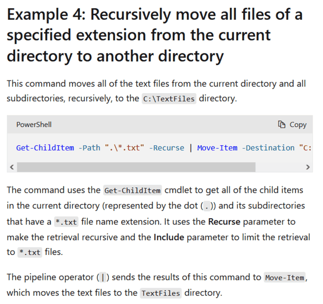

I have about one hundred folders. Each folder has both .jpg and .mp4 files. I want to delete all the .jpgs but not the .mp4s. I don't want to do each folder by hand. Does anyone know the Windows/DOS command that will do this. Just moving the files depending on file type is enough.

Rather than a delete, I suggest a move operation so that the files are not lost. That way if you ever need them again, you have them, but they are in a different folder so no longer in the way.
The Windows powershell move command will do this. Here's a good place in the Microsoft Learning Center to get the syntax and see an example:
https://learn.microsoft.com/en-us/powershell/module/microsoft.powershell.management/move-item?view=powershell-7.3
You want to look for Example 4. Here's part of it

That worked like a charm. I had well over ten thousand photos each from three to nine megabytes in size. I had them all backed up on an external hard drive. I never look at them. I resized them all, reducing to about 4% of the size of the original, moved the original jpgs to another directory with Powershell, then deleted that directory. Recovered about 60 gigabytes.
