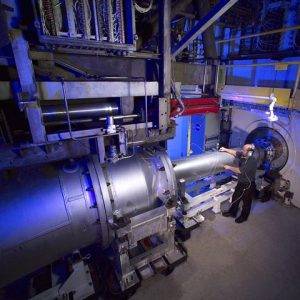

I mention wind tunnels because some designs use pusher fans to increase air pressure in front of the model and also puller fans to lower pressure behind the model that combine to simulate air flow at varying altitudes and automobile/aircraft velocities.
Some very high pressure blow-down tunnels also have large strong near-vacuum spheres at the end of the tunnel that rapidly lower the air pressure in the test chamber while also collecting the superheated air from the blow down (in some designs).
Picture of a hypersonic blow down wind tunnel test section with a human technician for scale.
