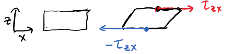

I'm wondering why Newton's Law of Viscosity sometimes has a negative sign in front of the viscosity and sometimes it doesn't?

It depends on whether stresses are considered positive if compressive or extensive, and how. this sign convention is used in determining the force exerted by A on B or by B on A.

I'm not quite sure how to interpret your explanation because Newton's Law of viscosity deals with a shear stress, not a normal stress? Is the sign convention discrepancy something like the attached? Where it depends on whether your shear stress is operating on the top or bottom of your infinitely small fluid parcel?

So for the red stress in the picture I drew before (attached above)...Imagine that there are solid plates on the top and bottom of a fluid column. The top plate is moving to the right and the bottom plate is stationary. The force of the top plate on the fluid is applied to the top of a fluid parcel in the positive x direction. $$TauFluidParcelTop_{zx} > 0$$. The force of the fluid on the top plate is in the opposite direction $$TauTopPlate_{zx} < 0$$
If we think of the fluid column as being composed of fluid layers then the force of the fluid above acting on the top of the fluid parcel below is in the positive x direction. $$TauFluidParcelTop_{zx} > 0$$. The force of the fluid below acting on the bottom of the parcel above is in the opposite direction $$TauFluidParcelBottom_{zx} < 0$$.
If the bottom of the fluid parcel (or the next fluid parcel below) also was dragged a bit to the right due to the fluid having some viscosity, there would be a flux of x-momentum in the negative z-direction. So $$MomentumFlux_{zx} < 0$$. This would cause a positive velocity gradient in the positive z direction (velocity is more positive at the top of the fluid column.) So $$ \frac{d (\rho u_x)}{dz} > 0$$. I believe this is where I get the Fickian relationship that is analogous to Fick's 1st Law of Diffusion and Fourier's Law. When I write it this way I preserve the negative sign in the analogy. So we get $$MomentumFlux_{zx} = - \nu \frac{d (\rho u_x)}{dz} $$
To continue on with the scenario...Then the parcel on the bottom of the fluid column would also impart a force on the top of the bottom plate. It is applied to the top of the plate in the positive x direction. So $$TauBed_{zx}>0$$. This force imparted to the bed per unit area is often called the bed stress. So we would get $$ TauBed_{zx} = + \nu \frac{d (\rho u_x)}{dz} |_{z=0} $$. In this version of the equation there is no negative sign.

The sign also determines whether the force is the deforming force (plate acting on fluid) or restoring force (fluid acting on plate).
