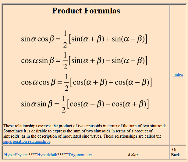

semc said:
If new frequencies are actually generated, what is the physical mechanism that generates these new frequencies?
It's a consequence of the math of multiplying two sinusoidal signals of different frequencies:
$$cos(2 \pi f_1 t) cos(2 \pi f_2 t) = \frac{cos(2 \pi (f_1 + f_2) t) + cos(2 \pi (f_1 - f_2) t)}{2}$$
You can look up the standard equations for multiplying trig functions on Hyperphysics, for example:
http://hyperphysics.phy-astr.gsu.edu/hbase/trid.html

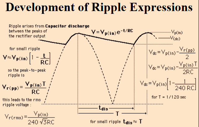

Another overstatement. A rectifier circuit will be operating with different charge and discharge time constants. A 'good' transformer with loads of copper and iron will produce a fast charge slope and a high resistance load will produce a slow discharge slope. The mean (DC) Voltage will be affected by both time constants. Without some regulation, audio amp psu's have to be over-engineered to reduce hum.
