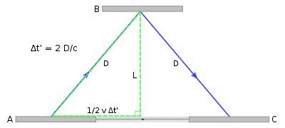

https://ac0077b2-a-62cb3a1a-s-sites.googlegroups.com/site/specialrelativitysimplified/home-1/minkowski-diagrams/Alice%20and%20Bobs%20light.png?attachauth=ANoY7coZsmLJQ0JAxFV72ZNxkbJBRzT6MCrPSCK-3J6r6q7Izraagl5byes4jkgMWSCX6HuegfgHK2T9WMjDRqFf4hiwqHDURP6iadByaTSGqqOQYVo6YMF5qgO27Bsr8136cganLCdkHQqxiFovfcGOXsUYCROHx5EmthiNTOzJ4cGRCeFtWBCgKdvX2gbuqm0ZWxrLfoiZJDt1VDrKloK8g7rMD7fa4nq766aEDc9T6Ygg0PEWufVX2U79EzbTBU7jnRGqgrycgQN2nox_xutMu9kDyjdx4HgjrbFyc0S49x0eXgZKP38%3D&attredirects=0
This is not an Minkowski Spacetime diagram. If anything it is a simple Newtonian diagram.
A simple diagram of the Frame of Reference of a resting observer, Alice; Bob is traveling along the x axis. He has a light clock with the light direction along his y axis. As he travels the path of the light in his clock is rotated by his motion. The speed of the light along the rotated path is 'c'. (The rotated path is only observed by Alice, Bob only sees his light travel at 'c' along his y axis).
Bob is traveling at 0.6c relative to Alice. After Bob has traveled 0.6 units, his light will have traveled 1 unit. along the rotated path, as measured by Alice.
Alice also has a light that emits a flash along her y-axis at Bob's departure.
Both lights travel in the y direction at the same rate, yet Bob's light also travels at 0.6c along the x-axis and has therefore traveled 1 unit along the rotated path, as measured by Alice, when Bob has traveled 0.6 units x-wards.
The increased duration of Bob's light journey (1 unit) is due to the relative speed between Alice and Bob and is only measured by Alice who measures Bob's light to have traveled 1 unit when her light has traveled 0.8 units; as Bob's light will be measured by Bob. Both lights are moving at 'c'; therefore the time passing for Bob, as measured by Alice, and only as measured by Alice, is measured to be 1 unit rather than 0.8 units.
That is purely a change in the time measured by Alice. Bob's clock has only run slow as measured by Alice, Not as measured by Bob. Indeed its rate is unchanged except as viewed by Alice due to her relative speed.
Now, before anyone complains that I am trying to rewrite anything, it seems to me to be crucial to this scenario, to relativity the experiments and all, to aver that Bob's unchanged passage of time is no more real than Alice's changed perception of time passing for Bob.
In Alice's Frame Bob's time does run slow and is measured to run slow. The Muon's time run's slow, because it is measured in the Earth's Frame of Reference in which it does indeed run slow.
Surely that is what is so important and fundamental to the whole concept and theory of relativity - it is all relative! No one observer's view is more correct than any other. Is that not what relativity is all about?
And if one swapped Alice and Bob in that thought experiment, would Bob not find that Alice's time runs slow? - And that both view are correct at the same time, whoever is considered to be the one moving? After all, all movement is and can only be relative...
Yet you appear to be trying to demonstrate something about SR from it. I don't understand what you are doing or why you think it is valid. You can't use a "Newtonian diagram" to demonstrate something about SR. The two theories are inconsistent.
In fact, I'm not even sure your diagram correctly represents Newtonian physics. You appear to be assuming that in Newtonian physics, Alice's light travels 0.8 units in the same time that Bob's light travels 1 unit. I don't see anything in Newtonian physics that would lead to that result.
It seems to me that you are expending a lot of effort trying to invent new conceptual tools for something that you don't yet understand. That's not very likely to be a good strategy; so far it certainly hasn't appeared to work for you in this thread. I think you would be better served by cracking open a basic SR textbook, like Taylor & Wheeler, and trying to learn to use the conceptual tools that have already been invented by people who thoroughly understand the subject matter. Or you could try Einstein's own book for the layman, linked to in post #84.
Thank you Peter, I understand that this is not a Newtonian, nor a Minkowski diagram. It was intended to be neither but to take Newtonian Mechanics with the stipulation that v cannot exceed 'c'; examining how that one simple change drawn using Newtonian Mechanics, affected the outcome.
You say:
but that is the whole point; that by making that one simple stipulation, that we know the the speed of Bob's light (as measured by Alice), leads to the inevitable conclusion that the time in Bob's Frame is dilated by the Lorentz factor with respect to Alice's time, but only Alice perceives this effect.
Obviously it is rather a pretty undefined drawing rather than a diagram helping to understand anything about relativity! You should update your knowledge about space-time diagrams if you like to understand special relativity properly. It's not such a complicated topic by the way!

https://ac0077b2-a-62cb3a1a-s-sites.googlegroups.com/site/specialrelativitysimplified/home-1/minkowski-diagrams/Alice%20and%20Bobs%20light%20clocks%20x%2Cy.png?attachauth=ANoY7cqB8EpgaGCeY6Ya0-Xwd6YR0yOUN0MXzotENjkerckDXmcSW-TAPlUyfTPy5VUs4dlVKSmD8uomd19vBesz6aMSYnJ43hdYE1CIjVT1WhdeRvN5tlGSRd3uEO2LtV6tJfDTh4wQUjpqw4wrhKv_t1DP75afXSluQu_kdifYn-EDcj9GAE0ro0SHjZiWTc7Pp7iPECBuSMGUaghramMJKU72AQyHvt7GBK83TPiRNg_cxKBdVQjDfa3W4HroCtRgwCmyC1j8WplLTJLkDhrdWkFDaPoeIFhs227-WNiqZqAmsN8PO4E%3D&attredirects=0
The first Diagram depicts Alice's and Bob's light clocks separating at 0.6c. Drawn from the perspective of an independent observer permanently situated midway between the two clocks. Each clock is moving at 0.3c relative to the independent observer.
When the clocks are 0.6 units apart the light in each clock will have traveled 1 unit to the mirror in that clock.
The following two diagrams are drawn for the individual Frames of Reference for Alice and Bob. Note, not times are depicted only the relative positions of the clocks and the lights in those clocks.
When the lights in the clock have traveled 1 unit, measured within each clock be the owner of that clock, both lights will have arrived at their respective mirrors. However the path seen by each observer of the other's light will be longer, due to the additional lateral displacement of the other's clock relative to each observer. Each light in a moving clock will be measured to have traveled 1.25 units in the stationary observer's Frame of Reference.
The light in each stationary clock will have traveled 1 unit, while the light in each moving clock will have traveled 1.25 units.
The lights have to be traveling at 'c'.
Therefore, as each observer will measure that, when the moving light has traveled 1 unit, it has only moved 0.8 units along the Y axis, that while 1 unit of time is measured to have passed in the moving frame only 0.8 units of time have passed in the stationary frame, because both lights are moving at 'c'.
This is simple mechanics using no more than simple geometry. It is a necessary consequence of the two postulates, that all movement is relative, not based on some fixed, privileged reference body; and the invariance of the speed of light. That is how it seems to me.​
Wrong. You are not using the relativistic velocity addition formula. You need to use that formula to find a such that . The correct solution to that equation is not . Try it. And then you will need to rework all the rest of your numbers.
As far as I can tell, it is the same incorrect reasoning based on a confusion about the meaning of that I pointed out above. I really think it would be a good idea for you to stop using your ad hoc idiosyncratic conceptual tools and try using the standard tools of SR instead. Your personal conceptual tools are confusing you, not helping you.

the_emi_guy said:
you can also look in Wikipedia under Time dilation to find examples of Grimble's diagrams (attached below)
The diagrams you show are not the same as the diagrams Grimble has been posting (and which are confusing him, not helping him). I agree that your diagrams are fine and can be used to help with a correct analysis of the light clock. The key is to be clear about which frame one is using, and about which time coordinates in that frame go with the various events being illustrated.

the_emi_guy said:
The OP is not inventing anything new here. He is simply working through the very common "light clock" exercise that appears is virtually every introductory text on SR. This exercise does not require, and is introduced prior to, Minkowski space-time diagrams and the concept of proper time.
I already mentioned the Feynman text, but you can also look in Wikipedia under Time dilation to find examples of Grimble's diagrams (attached below)
There may be some improper terminology involved (Grimble is high school level after all) but let's not throw the baby out with the bath water.
Thank you, 'the_emi_guy', you are right, it is these diagrams that are at the heart of what concerns me.
In the Wiki you reference it says, concerning the diagrams:
From the frame of reference of a moving observer traveling at the speed v relative to the rest frame of the clock (diagram at lower right), the light pulse traces out a longer, angled path. The second postulate of special relativity states that the speed of light in free space is constant for all inertial observers, which implies a lengthening of the period of this clock from the moving observer's perspective. That is to say, in a frame moving relative to the clock, the clock appears to be running more slowly.
Yet what is never specified in these diagrams is that those two times t and t' measure the interval between the same two spacetime events. That these are two measurements of the same interval.
Indeed expressed as a Spacetime Interval, they have the same value: t is the time of the resting observer, so S = cΔt and t' is the time of the moving clock, measured by the resting observer;
S = √(cΔt'2 - vΔt'2) = cΔt'√(1 - v2/c2)
and Δt' = γΔt
It seems important to me to recognise that it is one interval that is measured differently. that the proper time measured by a resting observer in a frame, is the same Spacetime interval measured in the moving frame. Two measurements made by the same observer the moving one including the distance traveled by the moving clock.
Yet I have never seen a very important aspect of this referred to explicitly; that both times are equally correct. I think this is very important for those new to this subject, for I know how it was for me when it seemed that the time in the frame of the resting clock was the 'right time', and the time of the moving clock was somehow a distortion due to that movement.
But all frames are equal in importance, there is no privileged frame. So each measurement is absolutely correct for the frame it is measured in.
One cannot think when a clock is measured to run slow, because of time dilation, it isn't real...
Yes, they are; they are representations of the same spacetime interval (or more correctly, two successive ones on the same light ray's worldline) in two different frames. But what is this interval? It is the interval along the worldline of Bob's light ray. It is not the interval along Bob's worldline, or Alice's worldline.
Here is what the diagrams are telling you, expressed in the standard language of SR:
In Bob's frame, the light ray's worldline passes through the following events: (t, x, y) = (0, 0, 0), (L/c, 0, L), (2L/c, 0, 0). These are two segments, each of which obviously has a spacetime interval of zero.
In Alice's frame, the light ray's worldline passes through the following events: (t', x', y') = (0, 0, 0), (D/c, vD/c, L), (2D/c, 2vD/c, 0). Note that I have written the x' distance for each segment as vD/c, i.e., as v times the coordinate time. One can also use the Pythagorean theorem to show that , or, what is more useful, that .
These are, as you say, the same set of three events, represented in two different frames. We can verify this by Lorentz transforming; the primed frame here is moving at velocity in the direction relative to the unprimed frame (because the light clock is moving in the positive direction in the primed frame, so that frame itself must be moving in the negative direction relative to the unprimed frame).
But, once again, what intervals do these events represent? They represent the intervals traversed by the light ray, not by Bob himself. And all of these intervals are null intervals--their "length" in spacetime is zero. The events that lie along Bob's worldline are different. In Bob's frame (the unprimed frame in the above), Bob's events are (0, 0, 0), (L/c, 0, 0), (2L/c, 0, 0). And in Alice's frame (the primed frame), Bob's events are (0, 0, 0), (D/c, vD/c, 0), (2D/c, 2vD/c, 0). And the spacetime "lengths" of the two intervals between these three events are each L/c, in both frames (because the spacetime interval between two events is invariant). This is easily verified by using the interval formula in both frames.
However, there is one glaring thing missing in all of this so far: where is Alice? No events are specified for Alice, so all of the above, as it stands, tells us nothing whatsoever about the relationship between Bob's "time" and Alice's "time". To get that relationship, you need to add Alice's events and show how they are related to Bob's events. All of what I said above about spacetime intervals (and which is basically the same as what you say about them) does not say anything about Alice's events. It only talks about Bob's events, and the events of Bob's light ray.
So now I have a question for you, to see if you actually do understand the physics: how would you add Alice and Alice's events to the discussion above (and to the diagrams emi_guy showed) to demonstrate "time dilation" of Bob relative to Alice?
It is Bob's interval, represented in two different frames, yes. But, as above, so far nothing at all has been said about Alice. And we were supposed to be showing how Bob is time dilated relative to Alice, by using the behavior of Bob's light clock. So, again, how would you add Alice and Alice's events to the picture given above to show that?
If I'm understanding the point here, this is not quite right. In the first diagram, where the light beam bounces vertically, I assume that we are labelling the frame in which this occurs the frame S. In this frame S, we have some emission event, and some reception event, and an observer at the origin of S (assuming that's where the light beam is located) can measure the time t by means of a single clock, without the necessity of introducing any means of synchronizing clocks. In the terminology of SR, this is a measurement of proper time.
In the second diagram, where the light beam bounces at an angle, I assume that we are labelling the frame in which this occurs the frame S'. In frame S', we have an emission event, and a reception event, but both events aren't located at the same spatial position. So if we assume that the emission event occurs at the origin of S', the reception event occurs at some location that is not the origin of S'. To measure the time t', we need to introduce some concept of clock synchrhronziation, or simultaneity. There are several ways we could do this, the approach I would use is to use two clocks, one at the location of the emission event, one at the location of the reception event, and some means of synchronizing the clocks.
If we can agree on this much, we can perhaps go on to explain the significance of this seemingly minor detail. But given the length of this thread, I'm not going to attempt to explain the significance of this observation until we agree on what we are measuring and how we are measuring it. For instance, perhaps the OP has some different notion about how we measure the time interval t' than hat I suggest, and it seems he wants to do things his own way rather than to follow a standard derivation of the problem (of which there are many).

Thank you. I know what is causing confusion here - it is indeed the jargon of SR. Unfortunately; I am afraid that unless I am careful I tend to employ 'interval' with its literal meaning rather than as SR jargon, as you put it.
https://ac0077b2-a-62cb3a1a-s-sites.googlegroups.com/site/specialrelativitysimplified/home-1/minkowski-diagrams/Lorentz%20factor.png?attachauth=ANoY7crGGigryP97e5eUZ51gcU-xKwyFXvA10ufVcgTOOVVdazJYzRAeHVE1KNSJHNOgpYuLYXsKRsC3cT6rxQ3dS2w_1obZPyfcKuOGg6jjrE87IzRquRr-n6TYn42u-TluP4ADVwuuT9BP811xAHK8tNdAYuV71hFY1j7WhGycSKQDeeBtRUaUIISVoNrA9tkgLXkdYLe0jCDhj9jpxmRAldZkQG0BsRciIbYVv2srxis3M9xVigNPlh-YUKydLHr6wODeRWQR6WkattjKdJPr1HrghXUDdw%3D%3D&attredirects=0
depicted in green, ct is the time axis of the resting observer, Alice whose frame is.
depicted in red, ct' is the time axis of Bob, as seen by Alice. Rotated by Bob's movement along Alice's x axis. Alice measures this, as can be seen in the diagram as reaching point (0.6,0.8) in time t - it lies on the 0.8 coordinate of her time axis using orthogonal cartesian coordinates.
ct' is the time that Alice measures for Bob to reach that point: the time that Bob measures, converted by the Lorentz Transformation Equation. Which converts that measurement to be relative to Alice. Is that not the point of the Lorentz transformations?
To take a measurement in one inertial Frame and to make it relative to an observer in another inertial frame moving with respect to the former frame.
The moving observer has the additional movement between the frames as an added factor in calculating the measurement relative to the moving observer. So the measurement relative to the moving observer will always be greater by the Lorentz factor, γ.
Alice does measure the Spacetime interval (0, 0) to (0.6, 0.8) in the diagram. That is √(t'2 - x2) = √(1 - 0.36) = 0.8, the same as the spacetime interval between (0, 0) and (0.0, 0.8), the proper time for Alice.
Note that (me being pedantic here?) in a Spacetime diagram, which I believe this is, as we are plotting space - x, against time - ct, then after 0.8 seconds it is Alice that is at point (0,1), and it is Bob, not Bob's light that is at point (0.6, 0.8) - because we are plotting x against ct it is Bob and Alice who are moving along the time axis and Bob is also moving along the x axis. Light doesn't come into it. It is Bob who has moved in Space and time. So we are measuring Spacetime Intervals and the two here referred to are the same - the invariant spacetime interval.
The difference is between time t - the proper time, measured by Alice on her time axis, and the coordinate time measured by Alice on Bob's rotated time axis.
The actual Spacetime interval measured, and experienced by Alice is 0.8 along her time axis, which is also her proper time.
Her measurement on the Spacetime Interval for Bob, who also is displace laterally, also calculates out to 0.8, which seems right to me, for that means that by taking into account Bob's physical movement, she can calculate that the Spacetime Interval (which is a measure of the time elapsed, having subtracted the effect of any distance moved), yes, the Spacetime interval for Bob has the same value = 0.8.
Which seems to me to be entirely reasonable that two clocks that are synchronised are measured to have the same Spacetime intervals between the emission of their light pulses and their reflections in their respective mirrors.
No, it isn't. Your diagram is wrong, as is your analysis.
You need to go back and re-read, carefully, the posts where I gave you the coordinates of the events in question. There are four events that a correct diagram needs to depict. Each event has three coordinates of interest, not two; your diagram depicts only two, and you are mixing up which ones they are. You can't represent those events correctly in a Euclidean diagram because the geometry of spacetime (not space!) is not Euclidean; it's Minkowskian.
Also, I would recommend that you not even think about Lorentz transformations at all at this point. You have not even reached a correct understanding of how spacetime events are represented in a single frame. You need to do that first, before trying to understand how the representations in different frames are related, which is what Lorentz transformations are about.
Here are the correct coordinates of the four events, in Alice's rest frame. All coordinates are given as triples, (t, x, y).
O) The origin. This is at coordinates (0, 0, 0).
A) The event at which Alice is located at coordinate time 1 unit. This is at coordinates (1, 0, 0).
B) The event at which Bob is located at coordinate time 1 unit. This is at coordinates (1, 0.6, 0).
C) The event at which Bob's light ray is located at coordinate time 1 unit. This is at coordinates (1, 0.6, 0.8).
There are three spacetime intervals of interest. They are:
O to A: Interval 1 unit. This represents Alice's proper time.
O to B: Interval 0.8 units. This represents Bob's proper time.
O to C: Interval 0 units. This represents the null interval of the light ray--all light rays have null intervals.
Your diagram and analysis does not correctly represent these events and intervals, even though I have described them to you several times now, and you have even calculated the intervals correctly. If you are inclined to dispute that point (which you did in your latest post), this should be a big red flag to you that you do not understand the correct representation of events in Alice's inertial frame. The coordinates that I have given above are correct; your objective should be to understand why they are correct, not to try to convince me that they are incorrect.
When we say that Bob is "time dilated" relative to Alice, we are comparing the intervals O to A and O to B, which are related by the factor . Interval O to B is shorter; that's why we say Bob's clock "runs slow" relative to Alice. I've said this before as well, but it is still not reflected correctly in your analysis.
At this point I am closing the thread because we are going around in circles. If you have further questions, please PM me.
If the top line were green, and labelled vt, this diagram would be a correct Minkowskii diagram.
Note that on a Minkowskii diagram, the square of the hypotenuse is not the sum of the square of the other two sides, as it is in Euclidean geometry,. Rather, square of the hypotenuse is equal to the difference of the squares of the other two sides. In the jargon, the geometry is called a "Lorentzian" geometry.
Given this, we can write ##(ct)^2 - (vt)^2 = (ct')^2 ##, and we get ##t' ^2= [1-(v/c)^2 ]t^2## This is backwards from your result, but it says that the proper time interval of the moving observer is shorter than the improper time inverval of a stationary observer, which is the result we are looking for.
A quick (though not complete) way of partially justifying why it's the difference of the squares that is constant is this. We can write the equation of a light beam in the unprimed frame (t,x) as ##(ct)^2 - x^2 = 0##. In the primed frame (t', x'), the equation of a light beam is ##(c't')^2 - x'^2 = 0##. And we know that c' = c, so we can say that ##(ct)^2 - (vt)^2 = 0## implies that ##(ct')^2-x'^2=0##. It turns out that we can make a stronger statement than this, it turns out that ##(ct)^2 - x^2## is always equal to ##(ct')^2 - x'^2## even when the quantity is not zero. The jargon for this is that the quantity ##c^2t^2 - x^2## is given a name, the Lorentz interval or the space-time interval, and that the space-time interval has the property that it's value is independent of the choice of reference frame.This implies that the time of the moving observer (in red), which is a proper time, is shorter than the time of the stationary observer (green). Which is as it should be.​
