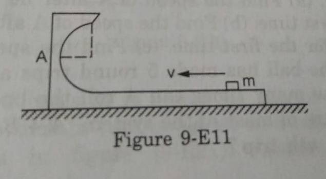

While coming across a question on Newton's laws,I found a case when a block slides on another block kept horizontally as in the figure.All surfaces are frictionless.
My concern is for the blocks to be in contact that is to move together will the horizontal velocities of both the blocks be the same in every part of the semicircular path or it happens only at the point A.

Sorry, but I'm having trouble figuring out your problem statement. Are you trying to figure out when the block will lose contact with the vertical semi-circular part of the track?
The horizontal velocities are only necessarily equal at point A.

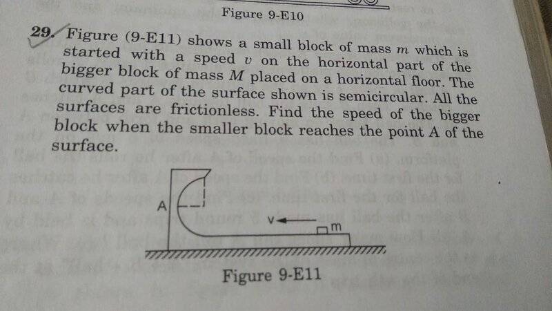

have posted the whole question in the figure.
my concern is why only at A.

Welcome to PF.Sorry, but I'm having trouble figuring out your problem statement. Are you trying to figure out when the block will lose contact with the vertical semi-circular part of the track?
I am asking for any point on the curve,what is the relation between the velocities of the blocks to be in contact i.e to move together.
A is the only point where the normal is horizontal.
The big block acts as a constraint, the small block cannot go into the big block, which means that the component of the velocity of the small block in the normal direction cannot be smaller than the component of the velocity of the large block in the normal direction (where the normal direction is defined to point outside the large block)
but there is no velocity of the smaller block along he normal as its always pependicular to the common normal.

Assuming the small block has been given enough initial velocity to get it to A in the first place, how could its velocity be the same as the big block at any other point ?

Imagine the mass ##m## being held still at some angle ##\theta## traveling with the mass ##M##. Masses ##M## and ##m## have the same velocity in that case. Now, if the small mass ##m## has some angular velocity at some ##\theta## (which it does) then it has some tangential velocity at ##\theta##. A component of that tangential velocity will be in the direction of the motion of the large blocks velocity. Meaning its velocity in the horizontal direction (as seen from the ground) will be greater than the velocity of the large mass. Point A is a special place, because the component of mass ##m##'s tangential velocity in the horizontal direction is zero.
