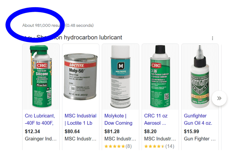

Are there any non-hydrocarbon based lubricants that can be used on instruments like micrometer threads? I know silicone grease exists, but it doesn't have the film strength to protect the metal. Are hydrocarbons the only game in town?
You really should learn to use Google. Search for "non hydrocarbon lubricant" and you'll get 981,000 results
