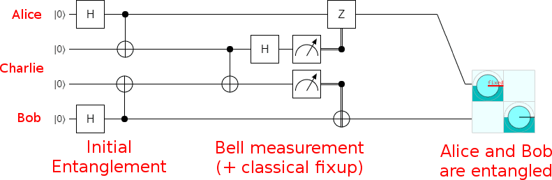

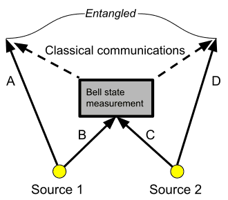

Can somebody provide some sort of diagram or picture, I am not sure I get what all the numbers refer to at this point.
For entanglement swapping, one of the main papers being discussed is:
Experimental delayed-choice entanglement swapping (2012)
Xiao-song Ma, Stefan Zotter, Johannes Kofler, Rupert Ursin, Thomas Jennewein, Časlav Brukner, and Anton Zeilinger

martinbn said:
This is too simplified, I was thinking more of something like this:
This images show also the classically controlled operations.
Taken from previous discussion: Ways to understand the delayed entanglement swapping. But I do not know how OP or the rest are labelling the qubits.

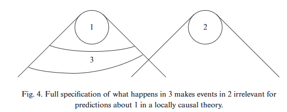

Morbert said:
Bell outlines what he means by nonlocal in his "La Nouvelle Cuisine" article. … and (I *think*) @DrChinese maintain that these interpretations are deficient in important ways.
The diagram in your #17 is my reference. Agreed that it well represents the ideas Bell wanted to all to analyze and discuss. However… sadly he died before a critical series of theorems and experiments made their way into canon. That new science actually makes the famous diagram either outdated - or even somewhat misleading.
In current scientific terms: the diagram should not include any area of overlap in the backwards light cones of 1 and 2. There is no requirement there be such.
So the point I am making: If an interpretation addresses this old (pre-1990) Bell diagram, they are about 25+ years behind. It’s time to tackle these issues straight on. As mentioned, I have no idea how nature does it or how best to interpret the science.
This is impossible in Minkowski space-time! The past light cones of any two events will overlap.
That's true, but meaningless. The future light cones of any two events will also overlap, also a meaningless statement. The relevant issue is: the photon examined in area 1 never co-exists/overlaps with the photon in area 2.
That's true, but irrelevant to the point under discussion. Bell's point, as shown in the diagram in post #17, was that in what he calls a "locally causal" theory, you can specify data in the past light cone of just one event, i.e., "above" the region of overlap (region 3 in the diagram) that makes it irrelevant what is in the overlap region, or anywhere else; the data in region 3 alone is sufficient to determine all measurement results in region 1.
And, as Bell says, QM is not "locally causal" in this sense; if there is entanglement between what is measured in region 1 and what is measured in region 2, then knowing all the data in region 3 is not sufficient to determine all experimental results in region 1.
