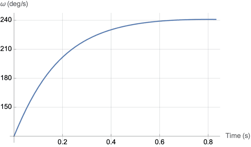

Hello everyone, I would really appreciate some help with a challenge I am facing. The challenge is to accelerate a particle in a circular path, but the acceleration must be non-uniform. In other words, the velocity does not increase linearly. The problem I am facing is shown below:
The scenario:
1. The particle starts at the Start Position (in this case 0°) with a speed of 120°/s.
2. The particle must accelerate to the End Position (in this case 180° away) where it has a speed of 240°/s
3. The acceleration must follow the profile in the graph, i.e. it must accelerate rapidly at the start after which the rate should decrease
The problem:
- Does anyone know how I can find the time (t) it takes to undergo this acceleration? It must occur precisely within the 180° of displacement.
The context:
I am writing a computer program to animate this motion. I can quite easily alter the particle's speed to follow the curve, but I need to know the timescale within which to do this. As a side note, I have been able to achieve uniform acceleration in this scenario using the rotational versions of the linear motion equations, but I believe that these no longer apply in the case of non-uniform acceleration. Please correct me if I am wrong though.
Any help would be appreciated tremendously!
You need to define the acceleration function in your graph.
Please can you advise how to go about this?
Either you have a function in mind; or, you do a numerical estimate of the graph you have drawn.
Note that at a starting rotation of 120 degrees per second, it's only going to take ##1.5s## to rotate by 180 degrees. With the acceleration, the total time will be less a second, at a rough estimate.
Mathematically, the area under the graph you have drawn must be ##180## units (degrees). You need to adjust the scale on the time axis so that this is true. As above, that means that ##t \approx 1s##.
A quick way to do this is to calculate the average rotational speed - either by integrating your chosen function or using the graph. You would get the total time from that.

Thank you PeroK, I understand the gist of what you are saying but I am not sure how to implement your recommendations. Could you possibly provide a worked example of your solution? I have tried looking at worked examples online but they always involve a known timeframe, so I am just perplexed as to how to define these functions you are mentioning.
A worked example would be really appreciated to help me understand the steps and the math.
If you look at your graph, you have unknown units of time (##\Delta t##)along the horizontal axis, and units of 24 degrees/s on the vertical axis . During the first unit of time the rotational speed increases from 120 to 168 degrees/s. The simplest approach is to take the average of 144 degrees/s as the average rotation duing that time unit. That means the object moved through an angle of ##144 \Delta t## degrees.
During the second time unit, the speed increased from 168 to 192 degree/s. Again taking the average gives a further rotation of ##180 \Delta t##.
If you do that for all time intervals, you get the equation for the total rotation, which must be 180 degrees:
$$180 = (144 + 180 + 200 + 212 + \dots + 240)\Delta t$$
That gives you an estimate for ##\Delta t## in seconds.
Clearly you can only do this with a precision related to how well you know the precise acceleration profile in your diagram. I'm just reading off the values as I can see them.
Likes Cato11
But doesn't this mean that deltaT just becomes smaller the more intervals we compute? E.g. if I am very precise and compute 1000 intervals, I will get a much smaller deltaT than if I did 10 intervals. This would produce a massively different timeframe depending on how accurate I am, but surely this should not be the case? I am assuming the red question mark in my image becomes equal to the deltaT I find.

Once you have ##\Delta t## you have to multiply it by the number of units on the graph!
Likes Cato11
D'oh!
I think that has fixed it.. not sure how I made such a ridiculous oversight!
Okay so I have just run some code using this method and on first impressions it seems to have produced exactly the correct result! Seriously I cannot thank you enough PeroK!
I still have to implement this in many different scenarios so if I run into an issue I will let you know, but for now it seems to have solved my problem. I appreciate your help tremendously!
Likes berkeman and PeroK
For whatever it's worth but mostly to satisfy my own curiosity, I investigated what kind of functions might do the required job. I came up with an angular speed given by $$\omega(t)=\omega_0\left(1+\frac{5t}{1+4t^{4/3}}\right).$$Here, ##\omega_0=120~\text{deg/s}##. The integral of the equation above is, $$\theta(t)=\omega_0\left[t+\frac{15}{8}t^{2/3}-\frac{15}{16}\arctan\left(2t^{2/3}\right)\right].$$ The equations predict that at final time ##t_{\!f}=0.832~\text{s} ##, the angle is 180.0° and the angular speed 240.9 deg/s. The two equations are plotted below.
Likes Cato11 and PeroK
