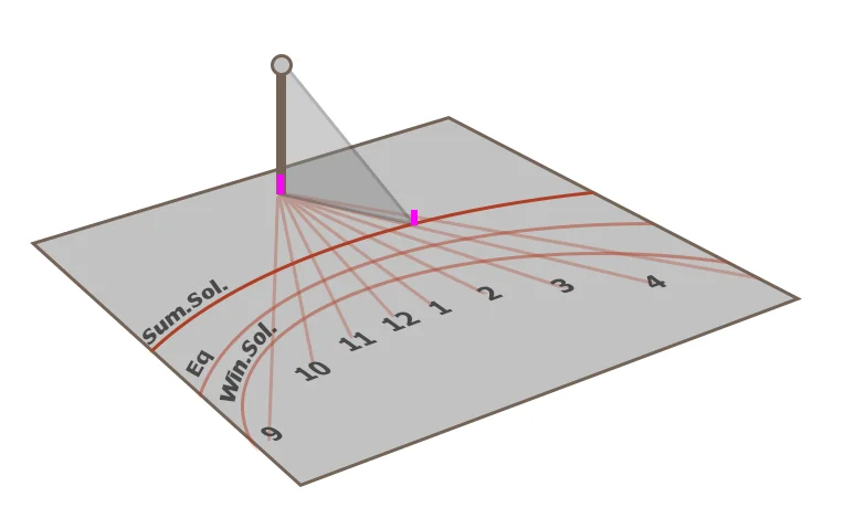

I want to track what the sun does to shadows on my property over the course of the day/year.
We have little shade but plenty of wind on my property. The upshot of this is that I have to be judicious in how/where I put up shade-creating barriers in various places around my property to maximise shade without unduly large windage.
My property is an irregular polygon and not aligned with the cardinal axes, so it is not easy to tell where the shade will be at a given time. For example, I have put up an umbrella next to our pool, but it can only shade the southish-side of the pool, and only during certain hours.
I'm sure I'm not the first one to want to know such factors. Thought I'd check what work has been done before building my own device.
I figure it's as simple as a pole about 3-6 feet high, with placed markings on the ground at appropriate times of the day by season. I expect the pole to trace out hypebolic lines across the target area (which can, in principle, range all the way from on side of the property to the other, from sunrise to sunset).
I'm trying to look up these patterns but I'm not sure what to call them.
Yeah but I'm looking for a gadget that I can put my backyard. A sundial but shows me inclination and direction, rather than time.

My idea of a solution is a stick on a board:
It's technically a sundial but the focus is as much on the distance (magenta) as it is on the hour-angle.

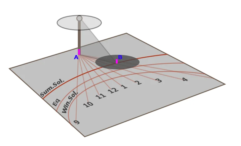

If I place an umbrella or tent on my property, the part that's in the shade shifts dramatically over the day. If we are mostly outside in late afternoon, it would be folly to place a picnic table or sandbox at A; it would be better placed at B.
(The corollary, of course, is: given a fixed structure like a sandbox, where should I plant an umbrella so it casts its shade appropriately?)
Notice, by the way, that by 4 or 5 in the afternoon, the shade is very far away from the umbrella, and it hasn't moved in a straight line throughout the day.
Also, unlike a sundial, it would not be aligned with noon at the centreline. I would align the device with my primary property lines, since that's the most useful to me, and noon would be marked wherever it falls.
(Though I have included winter solstice and ... equinoces? ... I am less concerned about winter and equinox - it's not like I need to worry about shade in the colder weather; they are only on the shadow-dial for completeness).
I could build it this way, but I'm just sure I'm not the first one to define this problem.
That's a solution for finding out some of the design information. But that won't provide shade where it's needed at any time. I feel what's needed is the inverse answer. You need to 'move the stick' in order to get a shadow on the favourite lounging spot.
I have realised that directing light to a particular place is a lot easier than directing shade. There was a thread about this a while back from someone with a shady garden and bright sunlight. It would be great to produce a steerable shadow mirror.
Good point. Yes, it would be a two-step process.
First step will be to figure out what the sun does on my property over time. Then I'll make a little map of my property and apply the geometry to it.
I could combine the two, and make the board in the shape of my property, but yes I'd still have to have a way to move the stick/ball around.
