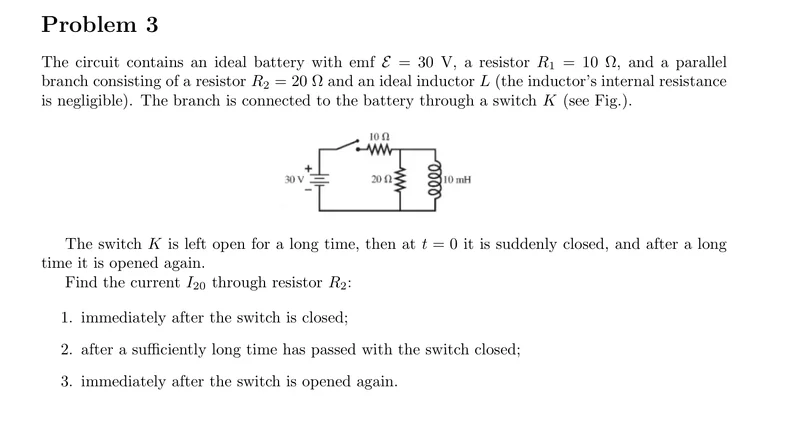

The circuit contains an ideal battery with emf E = 30 V, a resistor R1 = 10 Ω, and a parallel
branch consisting of a resistor R2 = 20 Ω and an ideal inductor L (the inductor’s internal resistance is negligible). The branch is connected to the battery through a switch K (see Fig.)
The switch K is left open for a long time, then at t = 0 it is suddenly closed, and after a long
time it is opened again.
Find the current I20 through resistor R2:
1. immediately after the switch is closed;
2. after a sufficiently long time has passed with the switch closed;
3. immediately after the switch is opened again
I(t)=I of infinite*(1-e^(-t/tau))
I of infinite=epsilon/R
tau=L/R
I tried to use the formula of I(t), but I can not determine the R to substitute. Also, it is the circuit of both parallel and series, so I am not sure how the current goes.
You don't need any formula to answer this. You need to understand what kind of circuit element the inductor behaves as in each of the limiting cases. Before t = 0 there is no current anywhere.
  1. Immediately after the switch is closed, the inductor will oppose any current that tries to go through it so it behaves as a _________________ .
  2. After a long time with the switch closed, there is a steady current everywhere, so the inductor behaves as a _________________ .
  3. Immediately after the switch is opened again, the inductor behaves as a _________________ . (Don't forget there is a current in it up to that point.)
I suggest that you draw three separate circuit diagrams with the inductor replaced by what you put in the blanks and analyze each separately to find the current in the 20 Ω resistor.
Likes rickyw2777, Gavran and DaveE
What formula did you use for I(t)?
I understand now. Thank you!
Likes DaveE and kuruman
The formula can be obtained by using the Thevenin equivalent circuit at the terminals of the inductor.
